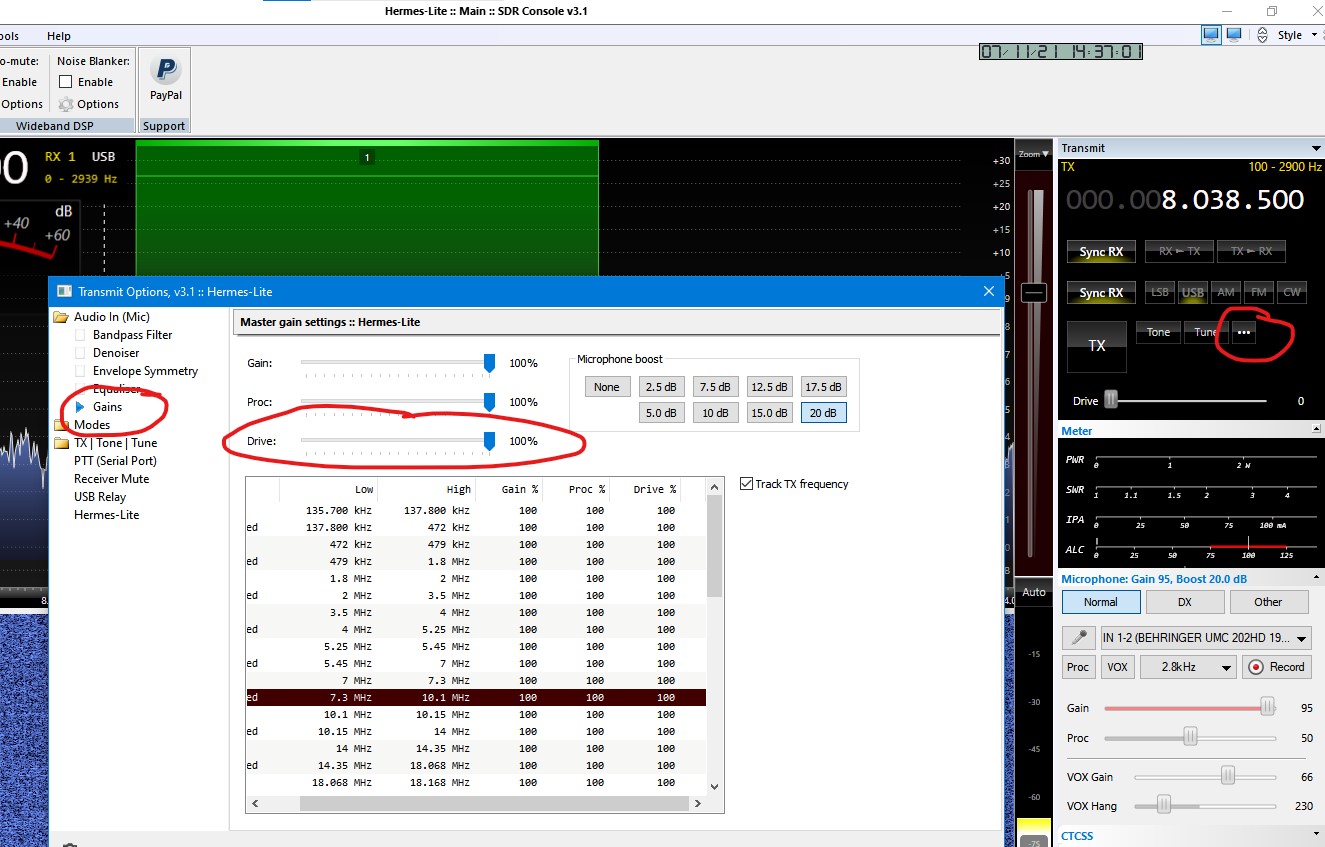

Hi Odie
I'm not sure if these options are the same for all transmitters (this is for my Hermes Lite 2) but as far as I know they are. Can be set on a band by band basis. (See attached image).
What's missing (unless I missed it) is the option to preset the drive for ALL frequencies instead of having to do it band by band. Simon?
By the way, it sets the drive that you will see when the master slider on the main TX DSP panel is set to 100%. I think that's actually better than what you requested because it sets YOUR 100% value.
But Simon, how about a "master" setting in addition to the frequency specific? Or the ability to be able to highlight more than on row in the table to adjust those rows simultaneously would also be good? But a "Master" drive with tick box enable would be best of all perhaps?
