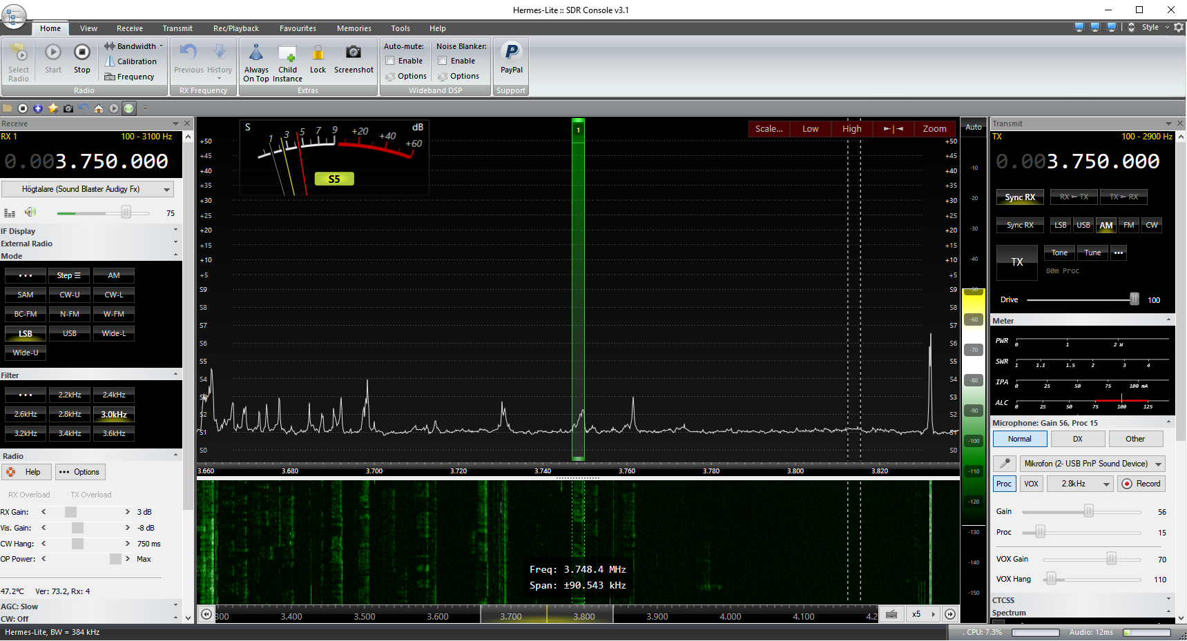

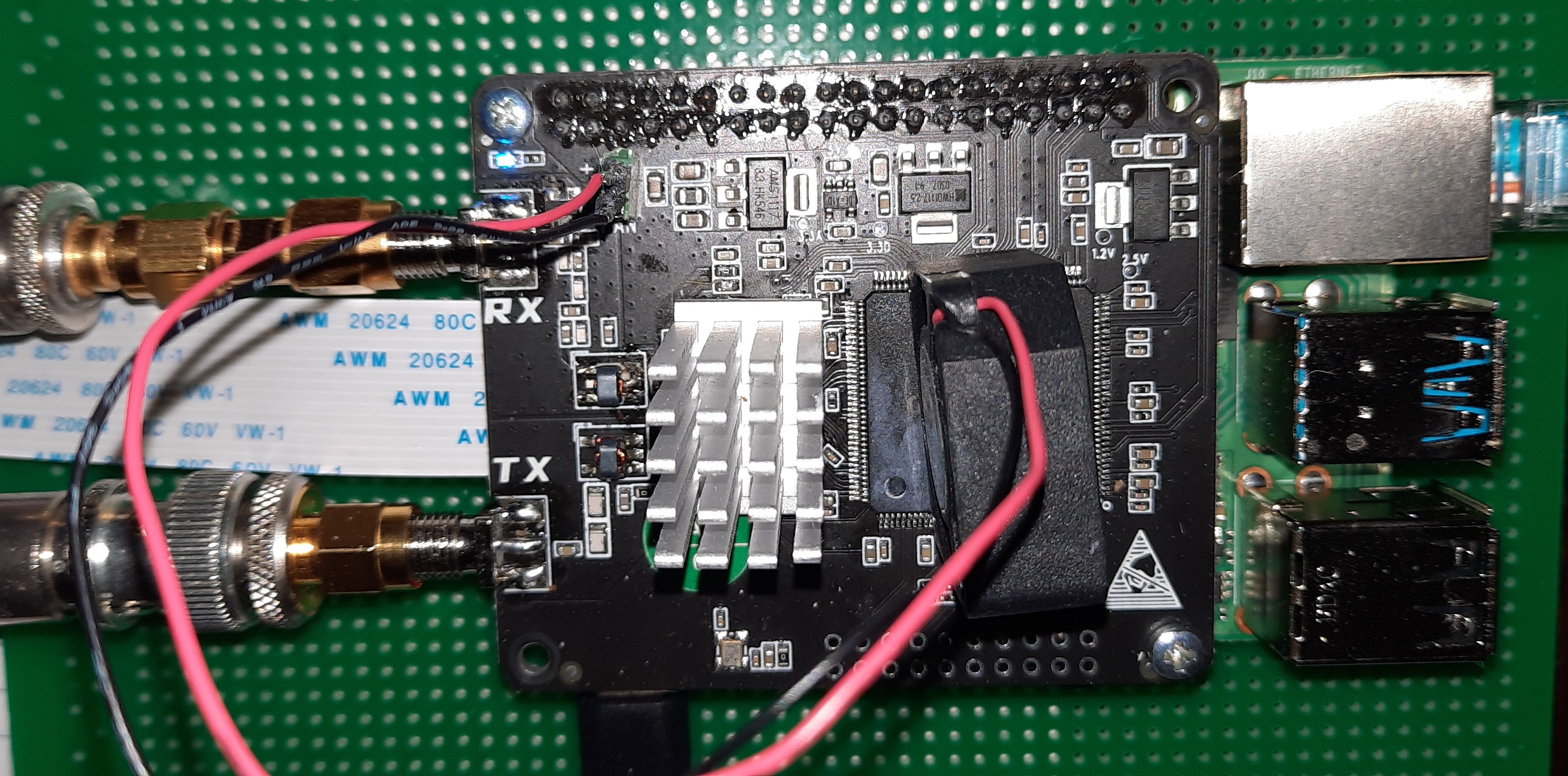

Ok here are some pictures and loggfile from SDR-Console
Radiberry_black is my board with custom test cooling mounted.
The other pictures are from Aliexpress site and SDR-Console in Receive and Transmit also the loggfile from first connect
SDR Console tmp.txt
(14.93 KiB) Downloaded 390 times
Re: Radioberry black board (Hermes Lite) no TX
Scrroll down in the TX options, please show me the Spectrum window, I want to be sure you are generating audio.
Use the Tone option as well (Drive set to 100) - we should see some ALC action, your screenshot with TX on shows no ALC so either the input device is not working / connected or there's another problem.

Simon G4ELI wrote: Wed Jan 19, 2022 3:00 pm Thanks,
Ok but i havent tested audio yet only AM and FM to get out carrier but no RF outputted, also I tested 2 tone but no RF
