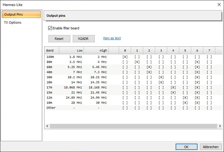

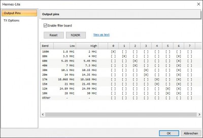

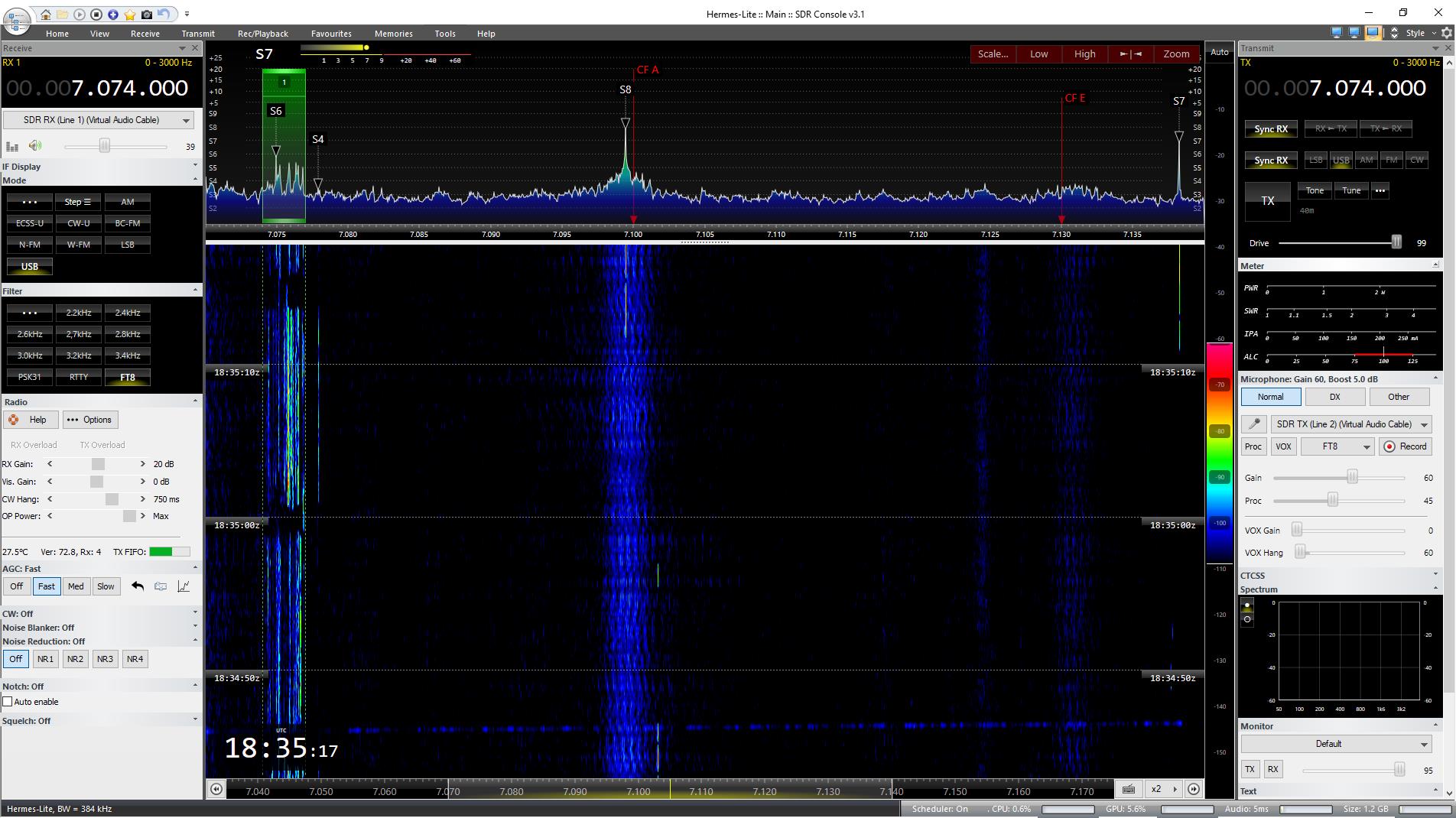

I just noticed that the n2adr relais are nolonger clicken when switching frequencies with following methods:
- RX Pane Frequency dial (Clicking or with Mouse Wheel on the digits)
- Scrolling within waterfall or Spectrum with Mouse Wheel
- VFO Control through Midi
- CAT Control (new Frequency)
When Clicking the frequency on the TX Pane everything works like in the August 3.1 version.
I've attached screenshots for you :)
