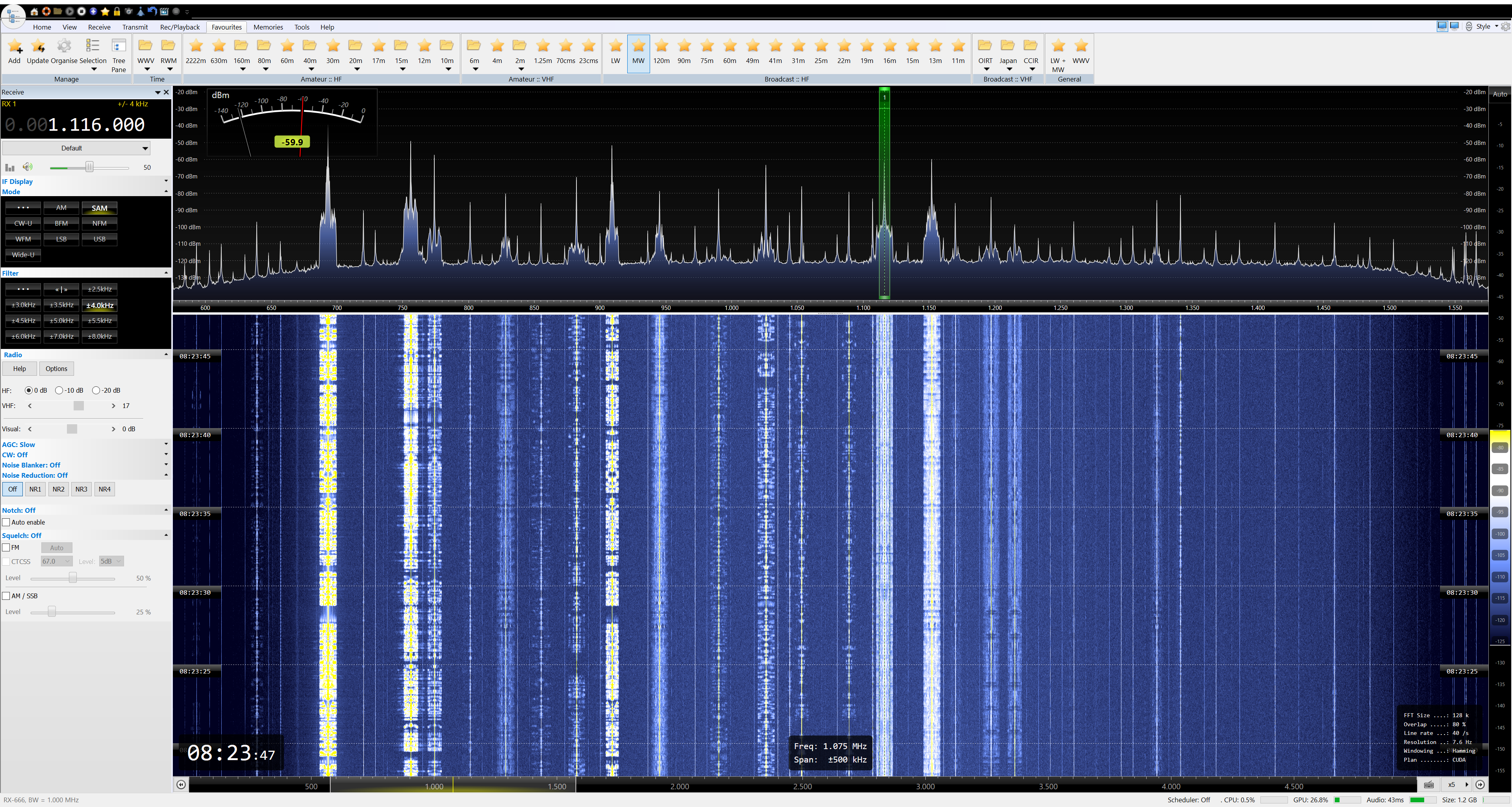

With new filtering in place for the 1 MHz bandwidth I have the CPU load down to 0.5% on my i5-8600K (not overclocked). The more I use this 16-bit ADC design the more I life it and look forward to new ADC-based SDRs in 2021.
I'm now ending the the RX-666 development for the time being and returning to other areas of the software.
i5-8600K, 0.5% CPU, Medium Wave
