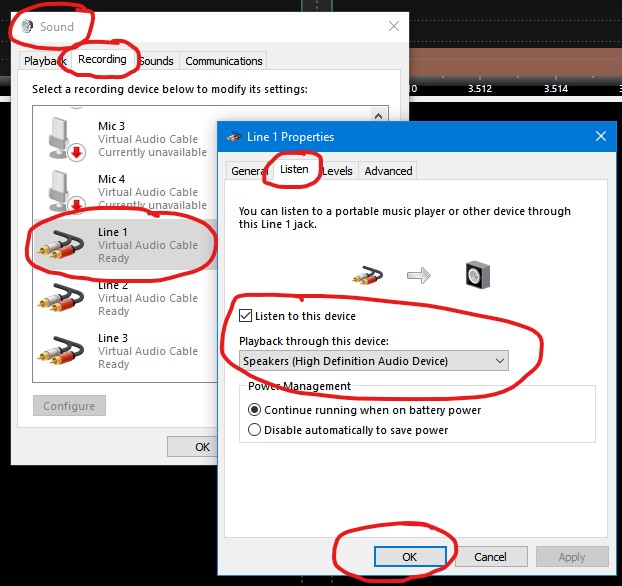

Press Windows Key + R at the same time to bring up the Windows "Run" dialogue
Enter the following text into the "Run" box then hit return:
mmsys.cpl
This brings up "Audio Devices" panel (see attached picture at bottom of this message)
Select "Recording" tab
Find "VB Audio" in the list of devices and double click it (or select it then press "Properties")
In the VB-Audio Properties box that comes up, select "Listen" tab.
Select tick box "Listen to this device" and select your preferred playback device (Speakers?).
Press OK.
You can now select VB-Audio as the destination in SDRC RX Audio DSP drop-down box, but you will be able to hear the VB-Audio "contents".
Hope it helps.
