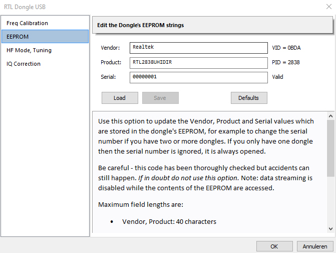

SDRplay, Pluto, Airspy, RTL-SDR 820 + E4000 are working in SDR# so RTL is using the zadig correct
SDRplay, Pluto, Airspy are working in SDRconsole
RTL-SDR did work older SDRconsole version but some mysterious way not get analyser action any more, SDRconsole hang, crashes need close SDRconsole manual.
In Radio configuration RTL = detected : Realtek RTL2838UHIDIR 00000001
I try several hours, i get lost in it, any hint will help
