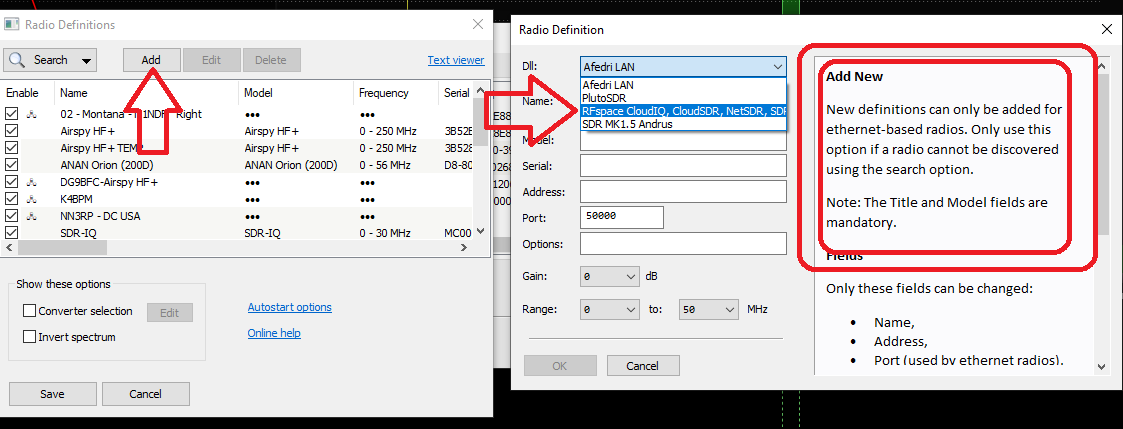

Not quite clear in your post, but are you using the ADD button, not Search in the definitions to build the definition?

Hi Kriss-
Yes, I tried the RFSpace menu choice of radio definition which SDR Console Continuum would not recognize when I tried to connect the Cloud SDR.
Then I created a new ADD entry for radio definitions, using first the Cloud SDR's ID, S/N and #address, which SDR Console Continuum would not recognize.
Then I entered in ADD the Cloud SDR's ID, S/N with the SDR-IQ's #address, and that was not recognized by SDR Console's Continuum mode.
73, Larry N6NC

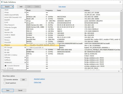

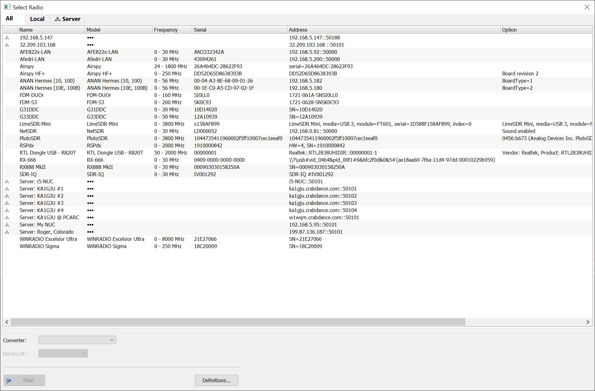

Simon-
Att 3 is a scrnshot of the Select Radio page within SDR Console. The SDR-IQ defn works fine and operates SDR Console.

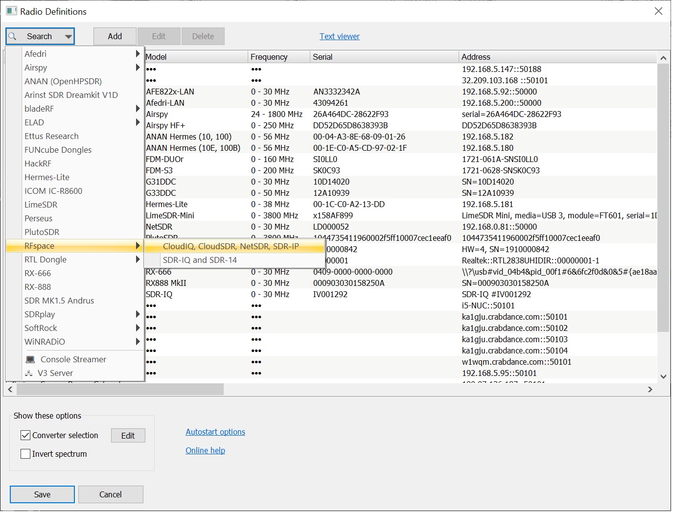

The Cloud SDR definition connects Console to the Cloud SDR, turns it on, and Cloud SDR responds to commands like the RF Gain attenuator, but there is no movement on the SDR Console screen, no signs of anything. (I went back to try the RF Space def'ns in the list of Radio Definitions within Console, but when I click on it it says "Nothing found. Sorry.")
Att 2 is the address finder widget within Cloud SDR. Using the address in the white area got the Cloud SDR connected to Console as described above.
Att 1 is a scrn shot of the Cloud SDR set up page. Maybe that tells you something about why the Cloud SDR is only partially connecting to Console.
73, Larry N6NC

- Posts: 2174
Re: Address for Cloud SDR in SDR Console
Larry,
Please do EXACTLY what I ask you here:
1) Add the Cloud SDR by using the Search option. Do not attempt to add the definition manually. 2) Attach a screenshot as an image of the definitions. 3) Start the Cloud SDR, add a screenshot of Console with the Ribbon Bar, Home panel visible so I can see the settings.
4) Attach the logfile https://www.sdr-radio.com/logfile.
(I do not want to know about the SDR-IQ, this is not relevant.)
Be sure you do not have a firewall blocking the UDP data stream from the Cloud SDR to Console.
