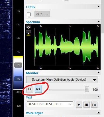

Forgot to mention. Did you know you can monitor your TX audio chain using the Spectrum Scope (great for checking if audio is top-clipping) and the audio monitor buttons I've circled in the attached picture?bob edwards wrote: Thu Oct 20, 2022 2:45 pm SDR Console 3.1 or 3.2 on Windows 10 - receive works perfectly, transmit very heavy dalek like distortion - disabling CUDA seemed to make no difference. The same distortion also shows up in a recording started from the SDR Console 'Record' button.
Any hints as to how to diagnose what's up, please? Cheers Bob G4BBY
If you have the "TX" monitor button selected, you only here audio on the selected monitor device when you are actually in live TX, but if you push the "RX" monitor button, you don't need to actually TX to monitor the mic
(or other audio input source) audio. Obviously best routed to headphones but great for adjusting Proc and EQ etc. for optimum quality prior to TX
