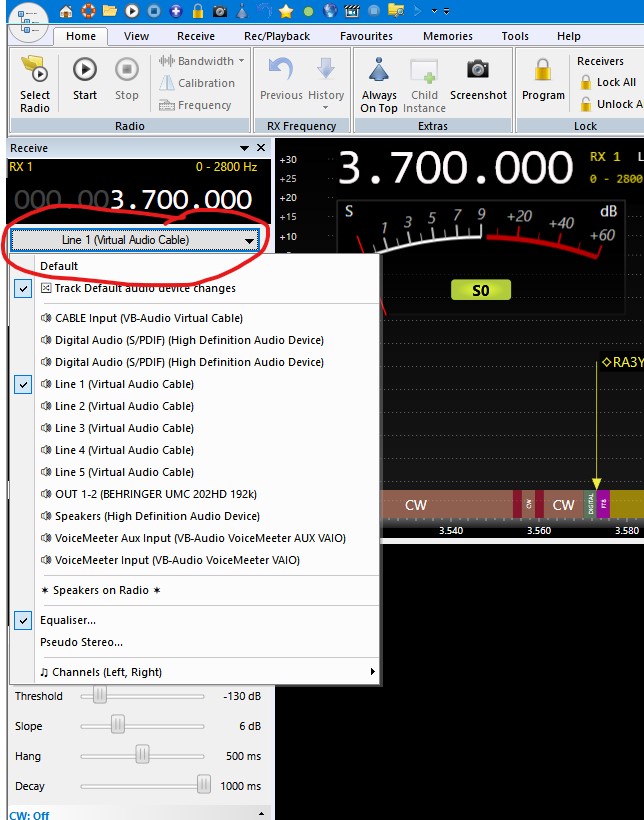

In SDRC, have you got the Audio Out selector set correctly or is it left on Default? If Default has been reset to PC Speaker then this might be it.
Check default playback device. Hit Windows key, then type "Run" (without quotations) to bring up the Run dialogue. Then in the Run dialogue, type "mmsys.cpl" (again without quotations). Brings up Audio Devices panel. Check what is set as default on the Playback tab.
Also you can set output device manually in SDRC (RX DSP Panel). See attached pic.
Re: SDR Console audio only thru PC speaker, not sound card speakers
Max wrote: Thu Nov 17, 2022 7:47 pm In SDRC, have you got the Audio Out selector set correctly or is it left on Default? If Default has been reset to PC Speaker then this might be it.
What I meant in my second sentence here was "If Default has been reset to PC Speaker IN WINDOWS AUDIO DEVICES then this might be it".
Then follow the procedure I outlines to rest "Default" to Speakers (or whatever the output you want to set it to is labelled as)
