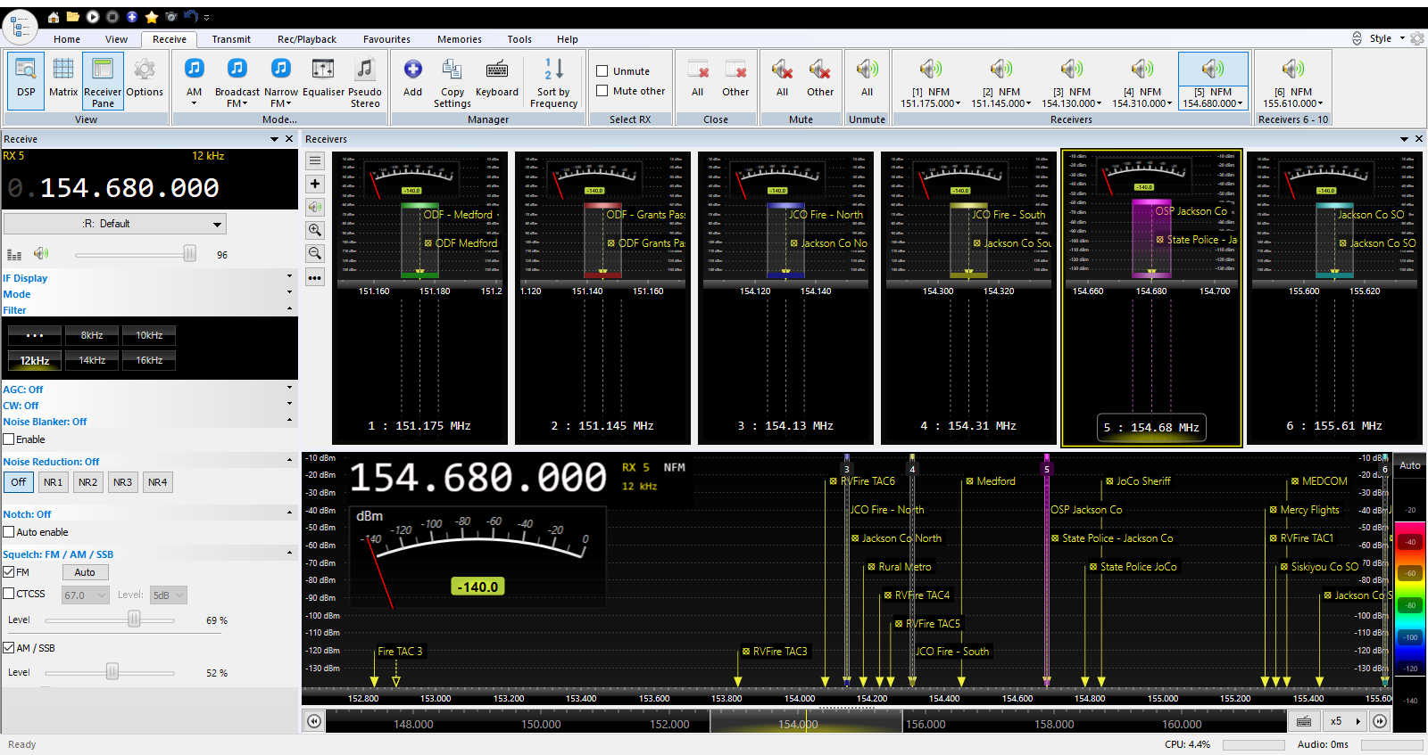

I am having an issue with receivers changing frequencies. The attached screenshot shows the mode I am in. This time of the year I use Console to monitor the primary police and fire channels. I use the mute / unmute buttons as well as hovering over receivers a lot. So my mouse is moving around a lot.
The problem I am having is randomly I will notice that one of my receivers has changed frequency of one of the other receivers. It is not like I have done something to change the frequency of the receiver, it is like I copied the frequency of one receiver to another. Like a copy / paste operation. I have tried to keep track of what I am doing to figure what causes this but have not been able to relate it to anything I am doing.
Is this action an available feature in Console? If so can it be disabled? Or is this a bug?
Thanks...
Dennis, KA6FUB

Jim, good idea about using the recorder. I started recording and then just tried changing the selected receiver. Did not take long to see receiver #2 change to the same frequency of receiver #4.
I have the video but cannot figure out how to add it to this post, it does not allow mp4 files. I will post it to my cross post in the old forums.
