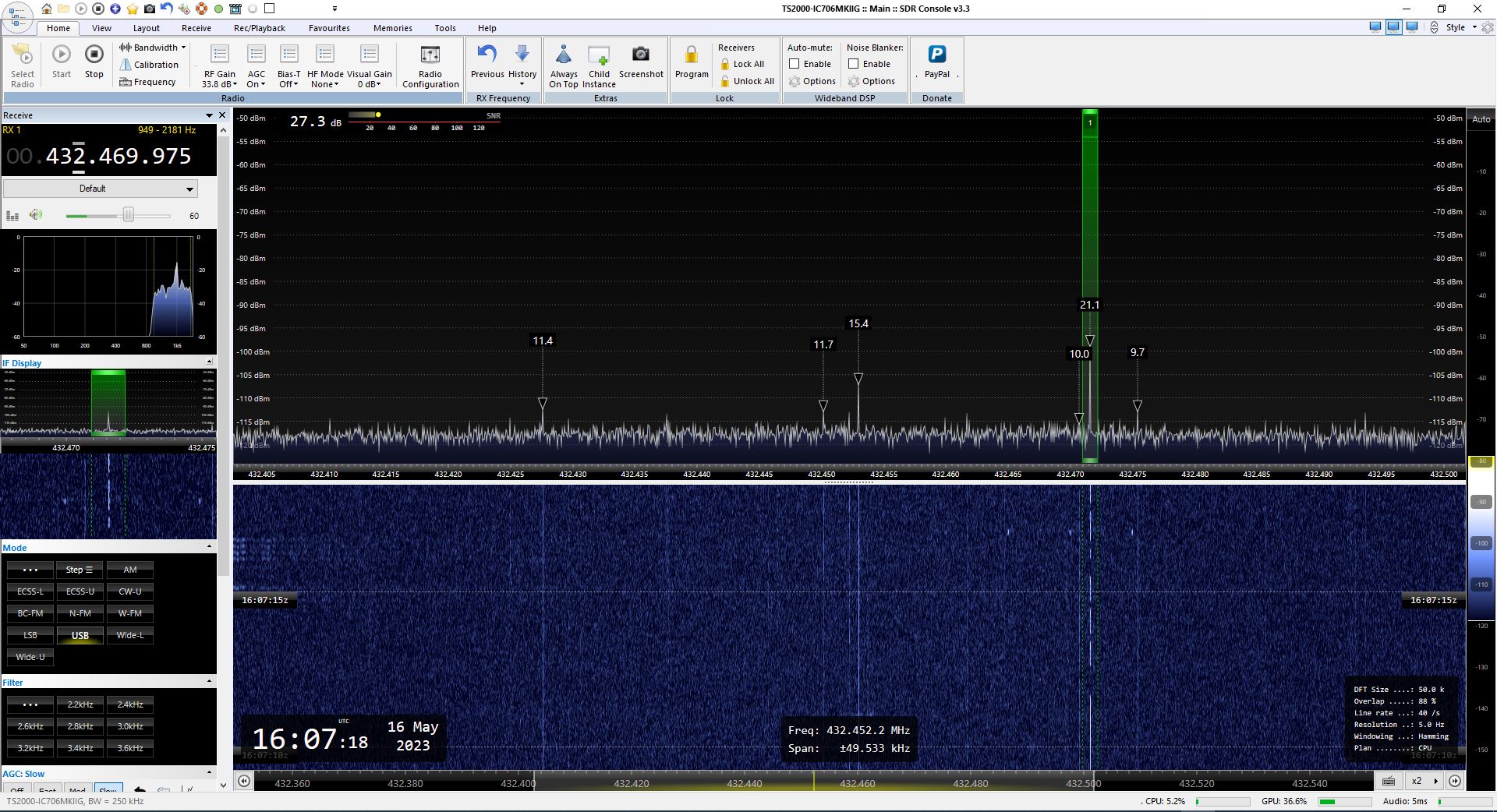

I am noticing an issue with this version while adjusting the waterfall contrast/brightness.
While I am moving the brightness bar, a noise us generated on the waterfall along with a "static" sound noise. That happens with more intensity if the tuned signal is strong.
Since it is a little difficult to describe the issue, I have uploaded a video to my youtube channel.
Video =>> SDR Console waterfall bug
My PC is an ACER ROI running Windows 10 64-bit
Also, I thought the noise was being generated by the mouse. I have replaced it and also accessed my PC remotely and the same issue happens.
**UPDATE** - I uninstalled build 2870 and went back to v3.3 build 2848, and the issue is still there, but with less intensity.
*** 2ND Update *** - Uninstalled 3.3 completely and reinstalled V3.2 build 2665 and the issue is completely GONE. Then I installed back v3.3 b2870 and the issue is back. I have another video showing version 3.2 and there is no Issue with the waterfall --- video here ==>> https://youtu.be/F7z2BCRNwSo

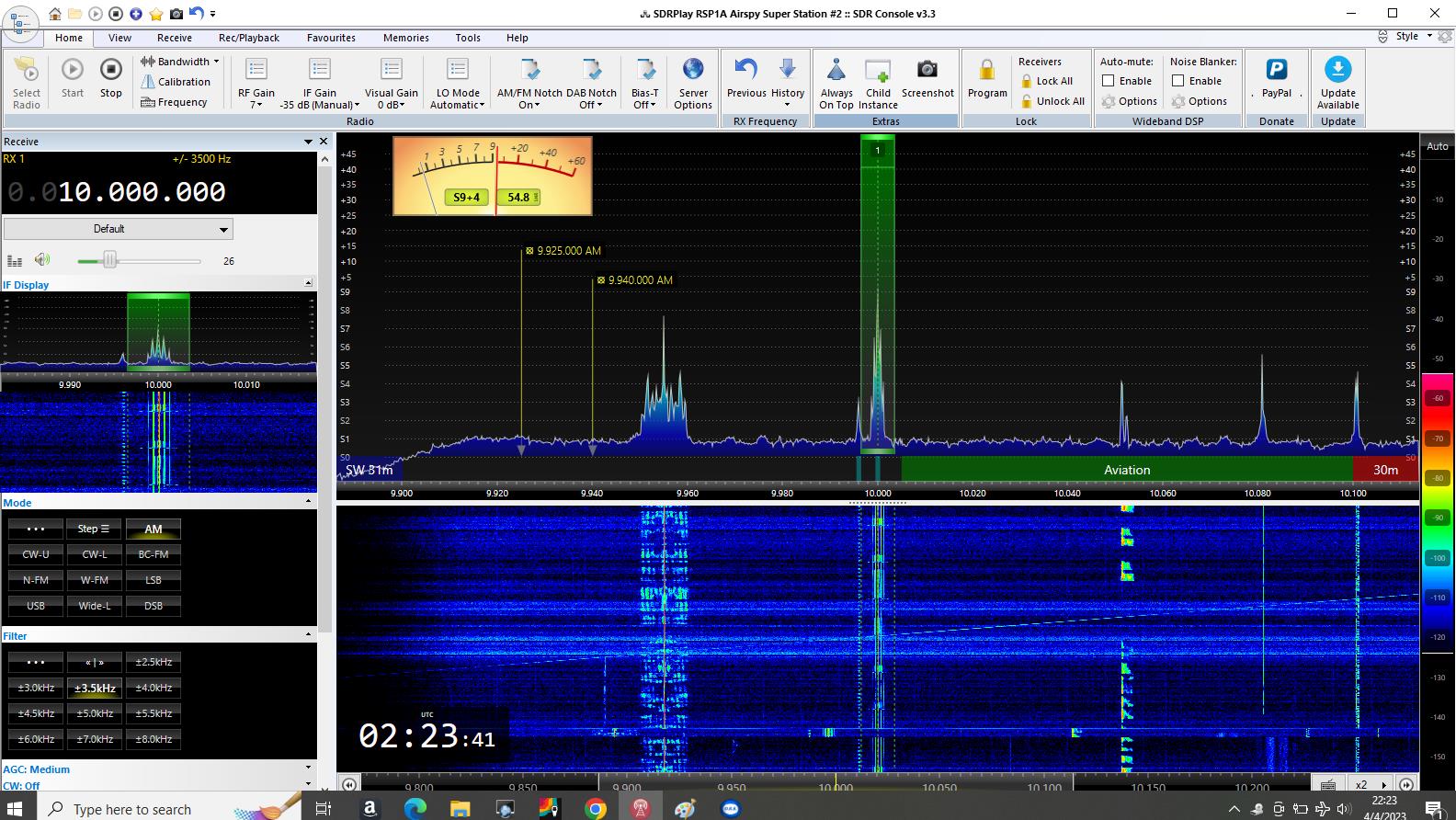

Re: 3.3 build 2870 - Waterfall "noise" while adjusting the brightness/contrast
Not seeing it here either. But mine is located out in the repeater shed +400' away from the operating laptop via SDRC Server.
The RSP1A I have has been modified with copper foil sticky tape on the inside of the plastic box to reduce QRM from nearby sources.
When located near the laptop, w/out an antenna, it was hearing all kinds of garbage. It's currently only a few feet away from the host
laptop (server) with a rats nest of USB wires going to the remaining three other SDR's on that server and USB cable to a remote IC-7100.
There's also a Raspberry PI Dstar machine that's nearby, not in a good RFI proof case too.
The RSP1A AGC tends to get overloaded with strong pulsing signals in the selected bandwidth (think CW). I found I have to run mine at
Manual IF Gain to stop the pulsing. Here's my settings, note the RF Gain at 7, RF Gain at 4 raises the noise floor!
Try my Super Station #4, and connect to the RSP1A on it and see if you get the same 'bug'

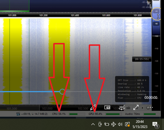

I think you might me exceeding the limits of your computer.
BC-FM uses more CPU resources vs SSB, from my humble observations. For example my Airspy Discovery at the max bandwidth of 912kHz show ~10%, BC-FM makes it go up to 23% at times, but I'm currently on an aging HP laptop i5 5th generation with 6MB RAM, and NO GPU.
Try operating at a narrower bandwidth versus 3Mhz as shown in your video. Here's a screen grab of your numbers.
KA1GJU wrote: Tue May 16, 2023 1:03 am I think you might me exceeding the limits of your computer.
That was first thing that occurred to me. Those CPU/GPU figures look extremely high. Sign of machine struggling badly? Maybe supply details of the computer?
