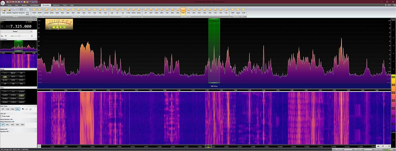

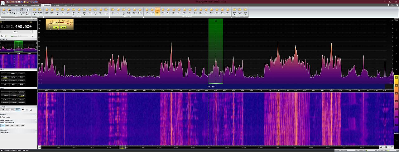

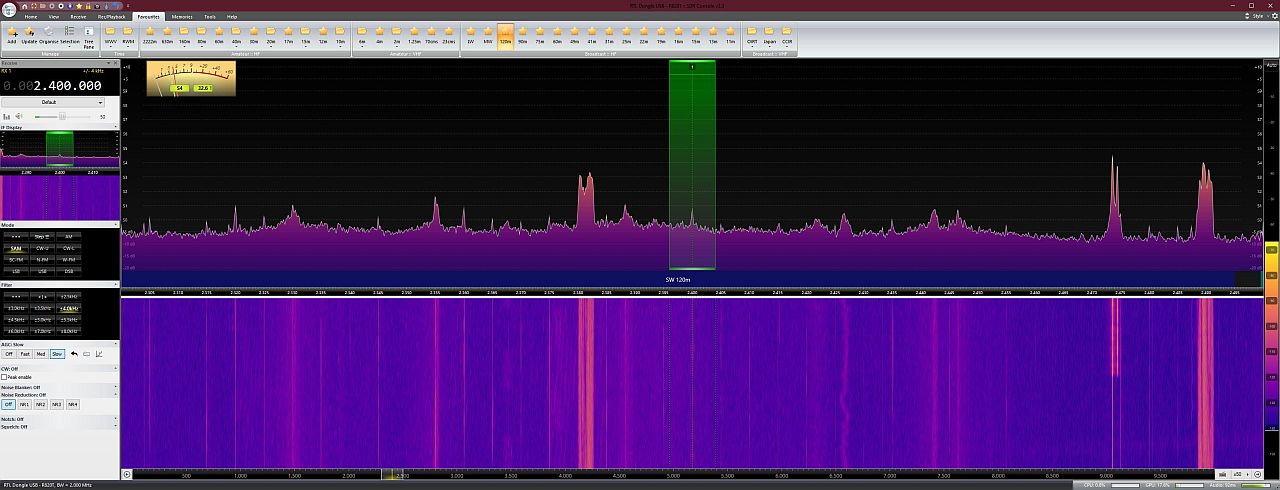

For example, if I'm currently on MW and then switch to LW (Favorites/Broadcast::HF), many fragments of the previous band remain and I'm receiving stations that aren't broadcasting on LW. If I press STOP once and then START again, everything is fine.
This behavior can be reproduced when switching from any band. Sometimes I have to press stop/start while scrolling with the mouse wheel to get back on track.
Can you do anything about it? And if so, how?
Greetz
Micha
PS: I've attached three files to illustrate this. I just did that.
So I hear a station in the 49m band (01_listen), click on 120m and hear/see something completely different there (02_change). After a restart I get what I expect (03_restart)

I'd guess it is a feature of the dongle. The dongles are 8 bit devices. They are VERY easy to overload. Perhaps you could reduce the signal level into the dongle and get improved results. Personally I'd reserve the RTLSDR dongle for 50 MHz and up. An AirSpy Discovery is moderately expensive; however, it's performance over the frequency range you apparently want is stellar.
Re: Restart after band change (RTL-SDR) ?!
Look at the Ribbon Bar, Home, Radio and reduce the RF Gain. As jdow says, it's easy to overload.

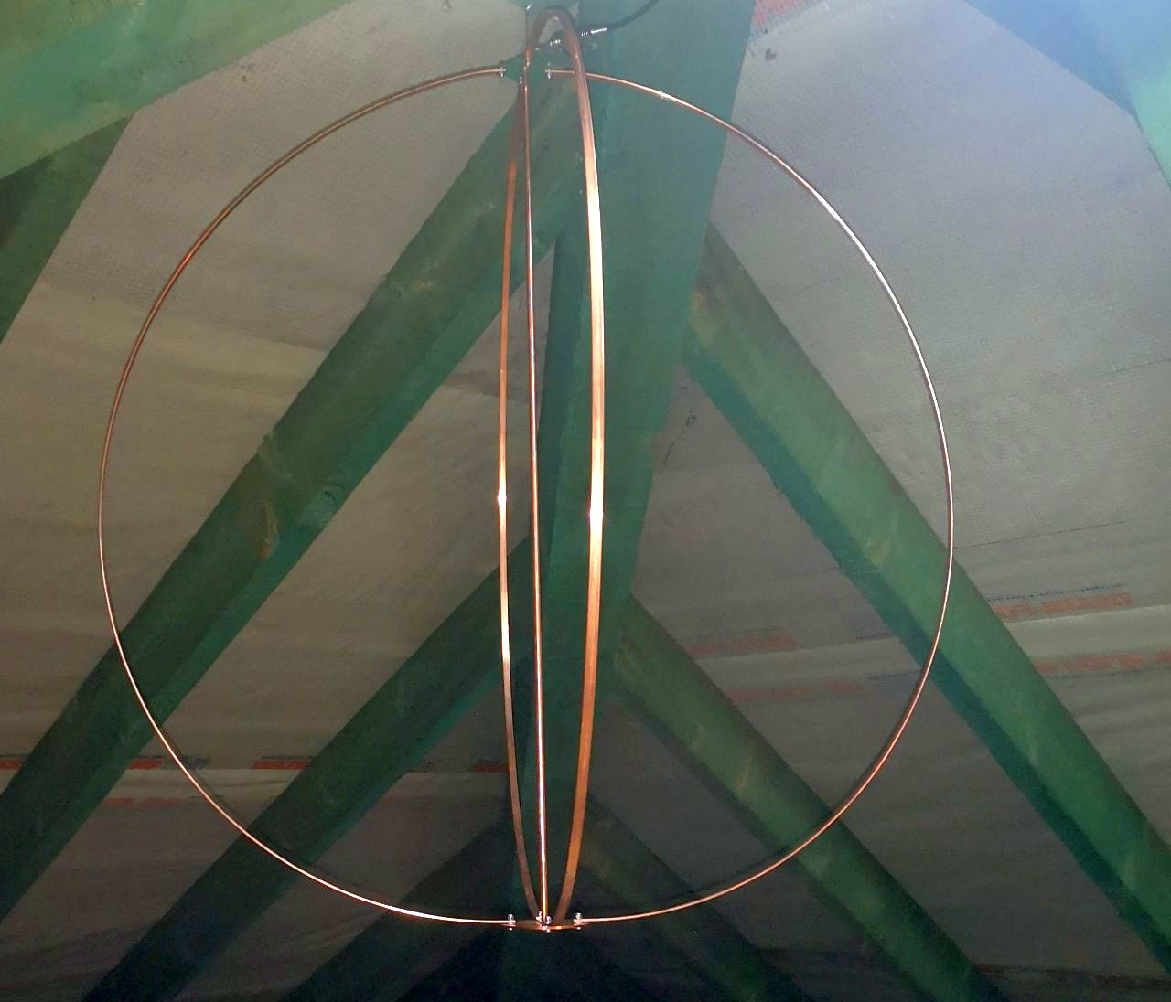

PS_2: I use a active splitter between my Loop and my RX which I can use to attenuate or amplify any output. Together with the overlapping control of the two loops at a 90° angle, I find this to be optimal...
The small one under the roof. Same electronic from Reuter as the big one
