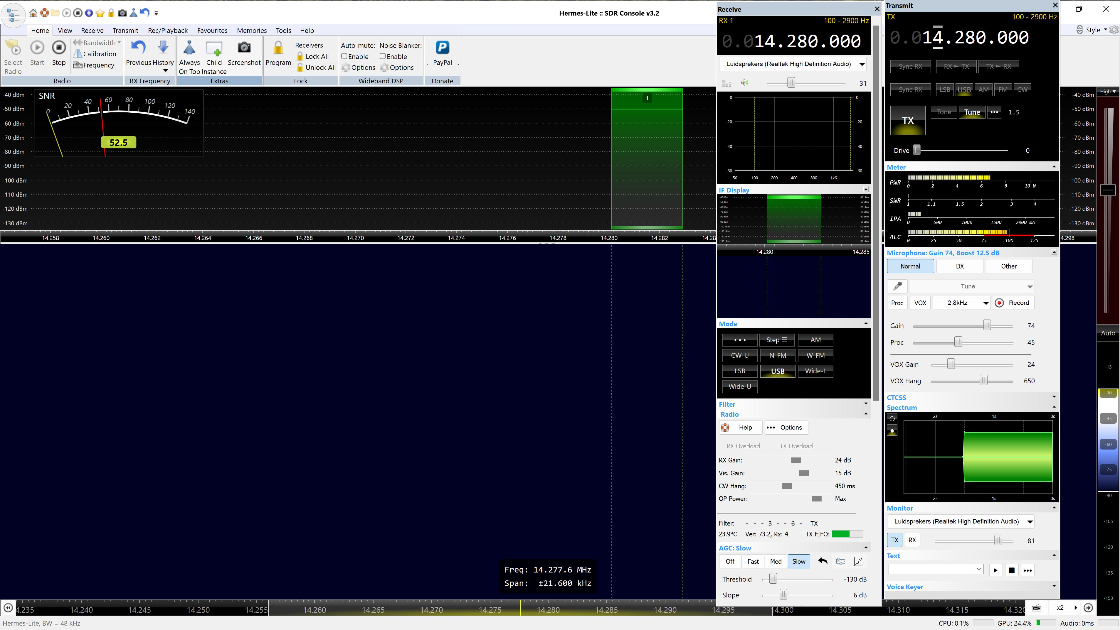

I think we went through this before? You MUST post SCREENSHOT as an ATTACHMENT showing the radio WHILE IN THE FAULT CONDITION. I do not think we have yet seen one clear screenshot of the problem that you are describing?
So, make transmission where you are getting no power out and show a FULL SCREENSHOT. You have power out when using the CW jack, so there is almost certainly no fault on the HL2.

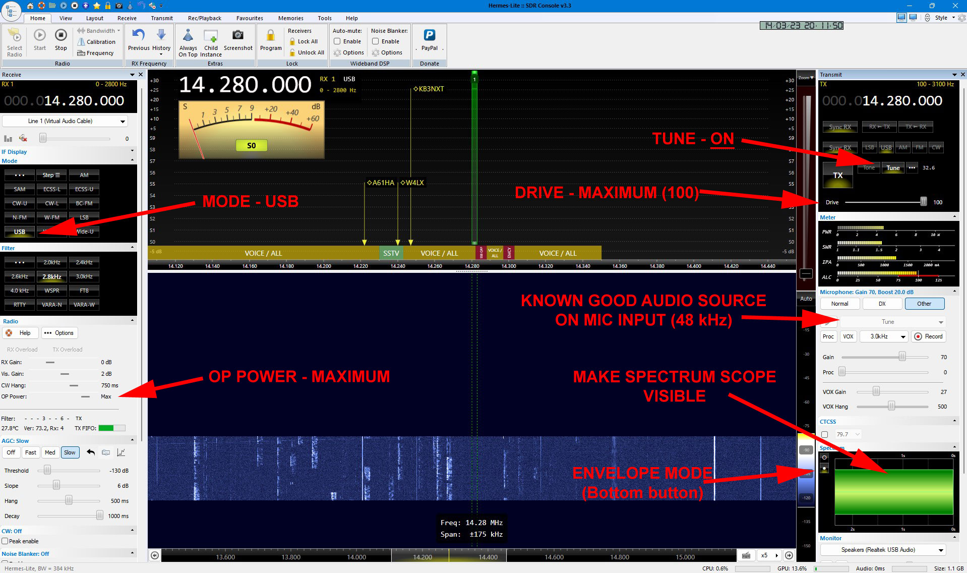

I am attaching a screenshot of what to do and show. Dock all panels as shown. DO NOT float panels over the top of other panels.
Copy the settings shown in red on my screenshot EXACTLY, then ATTACH it to your response. We will then be able to diagnose the issue.

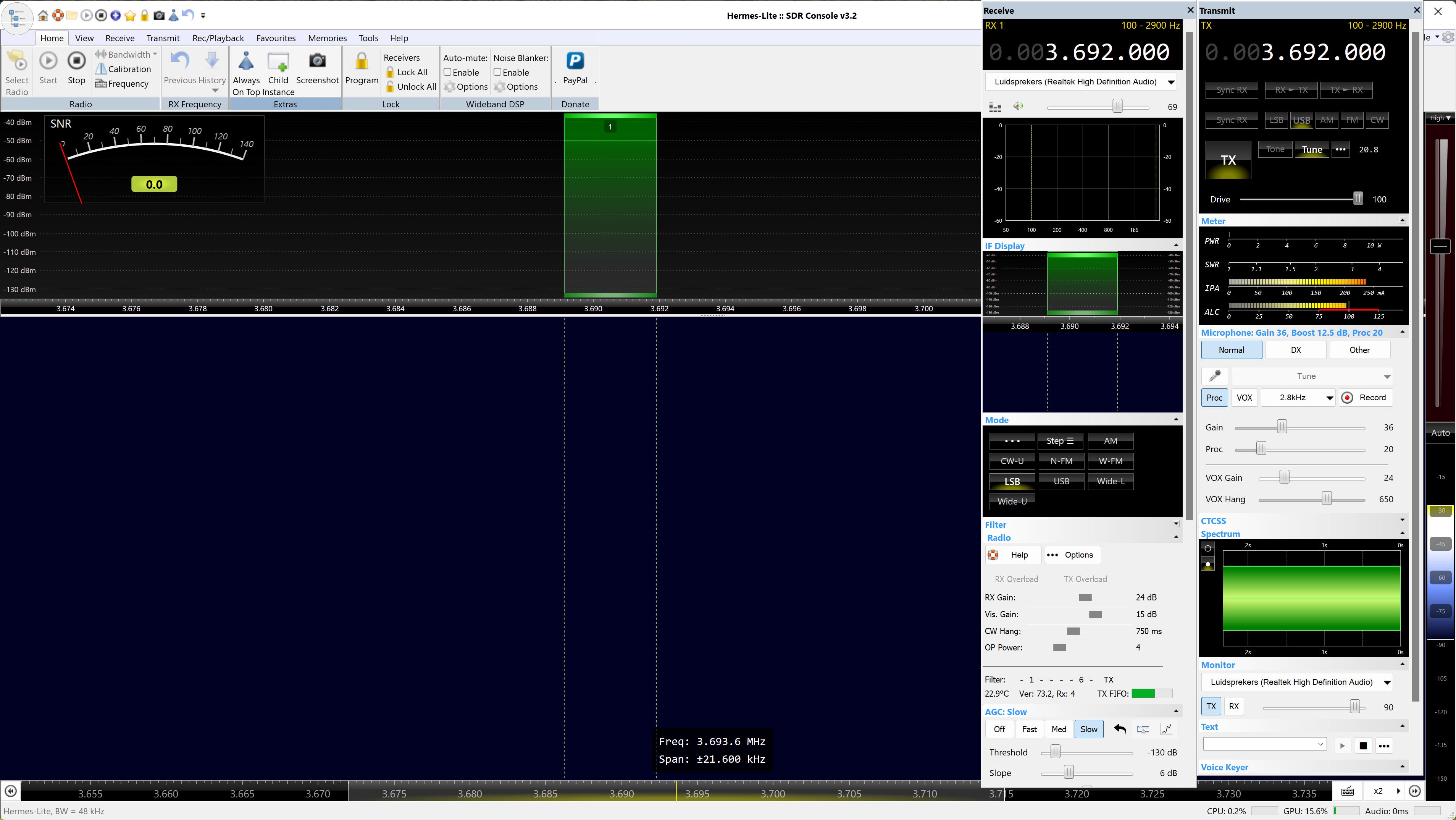

set all settings from your screenshot to Console exactly.
hit tune and made screenshot.
No power output at HL2 which is connected over SWR meter to Dummy load
Tested straight key and output is then 5 watts
Here are my screenshot jpg and txt file.

Hi again Gerrit
Absolutely no problem. We want to get you on air, which I am sure we will be able to. 61 years here so not far behind you!

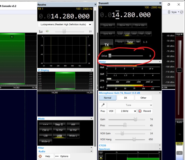

So the problem in your screenshot.....DRIVE is set to ZERO!
Please see my attached picture highlighting the problem in your screenshot. It does not matter what you have Drive set to immediately before you push TUNE. As soon as you push TUNE button, Drive is reset to ZERO. So now you need to increase DRIVE when in TUNE mode and you will see the power output you are looking for.
TUNE slider resets to zero as a safety measure if high power linear amplifier is attached. This is intentional behaviour. You can change this to prevent "Reset to Zero" if you wish to. I don't recommend this if you are going to attach amplifier. If no amplifier then you can change it.
But first, let's get some power out for you. Hit TUNE then increase DRIVE slider. Then report back here (with Screenshot showing same as in your last shot, but with DRIVE at MAXIMUM.

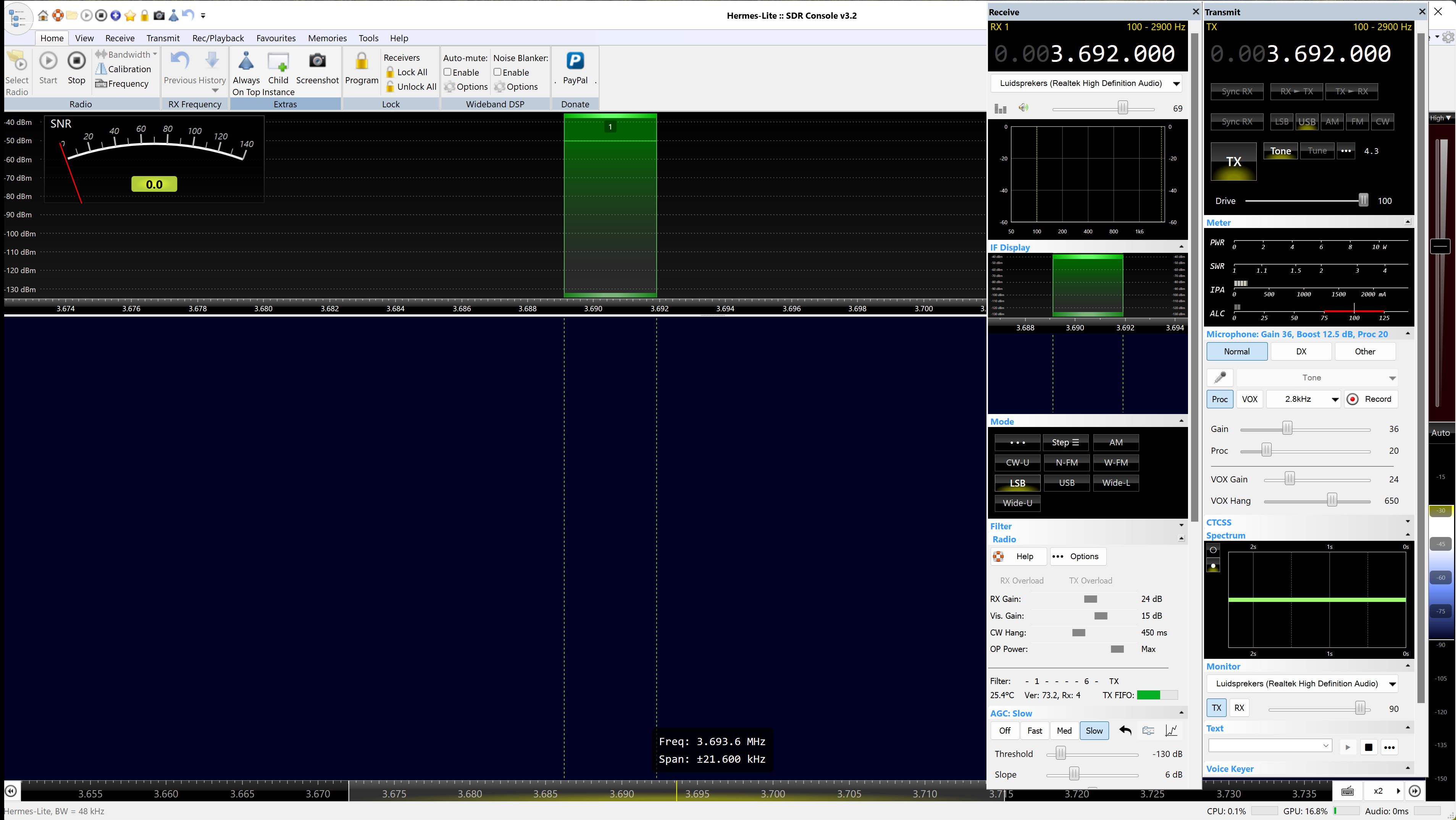

First test was of course try to see if I click tune and then take slider to full and watch the SWR meter.
There was no power output. screenshot made.
The slider to max but no output

Re: Problem in HL2 or setting false in sdr-radio ?
Hi Gerrit
OK. I think we may be getting somewhere.

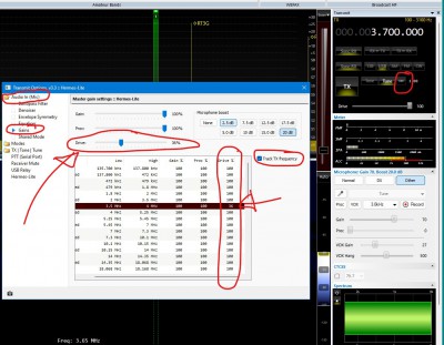

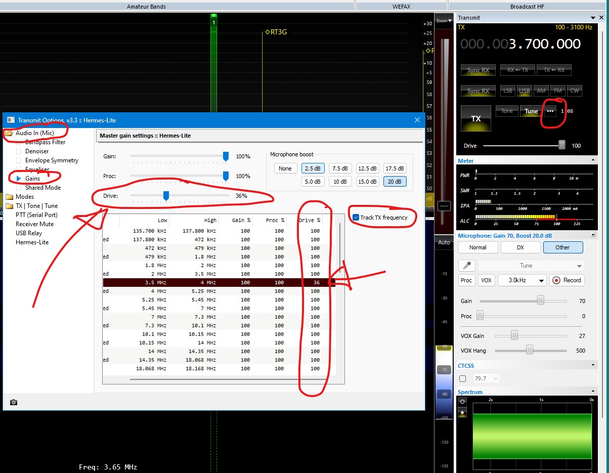

Please see attached image. Please check "MASTER GAINS" > "DRIVE" slider setting. You may have inadvertently reduced this at some time? Make sure it is set to 100 on ALL Frequency bands in the panel shown (see circled section).
Please put screenshot here of this panel, showing the DRIVE setting in the table for every band (the column I circled).
See in my attachment I have managed to copy your situation exactly!
