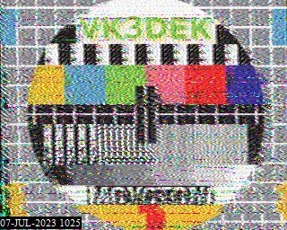

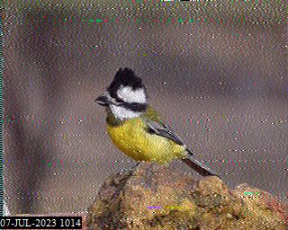

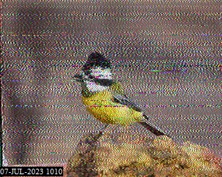

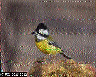

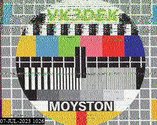

Now onto the quick test we did last night on 40m , distance around 1200klm , the band a bit crashy/staticy both ends , sigs around S8 both ends and fairly steady , same goes for the Noise .
These are the RX pictures i received
1st is YoniQ then Scottie 2 look at the time which is the last 4 numbers in UTC , IE:1026 utc
3, 4 , 5 are YoniQ , then Scottie 2 , then Scottie 1 being the last one
