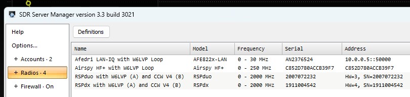

This is really a minor issue, but in my list of radios available to the public, the Afedri LAN-IQ is listed as having a frequency range of 0 to 30 MHz, when in fact it has a range of 0 to 1700 MHz.

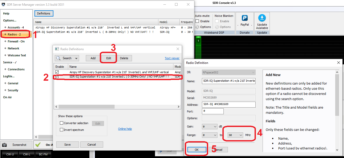

You can adjust it in the Server Manager Radio Definitions. Select the radio, hit edit, then change the frequency to what you want.
See attachment!
See attachment!
