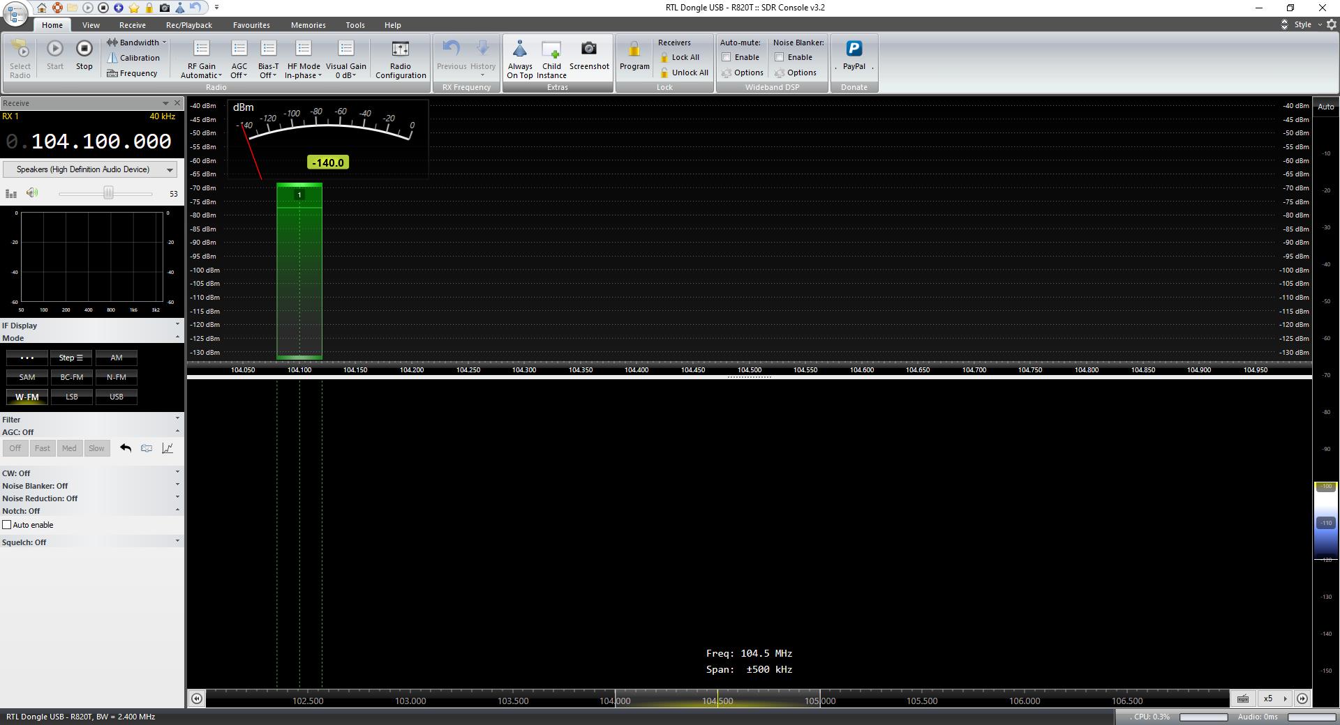

I recently installed SDR Console after running a few other SDR packages, and connected up my RTL SDR Dongle. Selecting the RTL SDR as the radio with a bandwidth of 2.4 MHz, and pressing start I get - Nothing. No audio, no visual dospalys, just the windows sitting there.
Went back and checked my SDR dongle is connected and receiving with some other form of application, so there is a signal there but still nothing displayed. I must be doing something obviously wrong, but for the life of me I can't work out what.

Please ATTACH a full screenshot in the "fault" condition with the RX DSP window open and docked left. Actually, supply two screenshots. One with the Home tab selected and one with the Receive tab selected.
Use the Screenshot tool (little camera icon right at top of screen) to take the screenshots and do NOT crop or edit those screenshots. If you do that we maty be able to see what's going on.

Thanks for the prompt response Max, see attached screenshots.

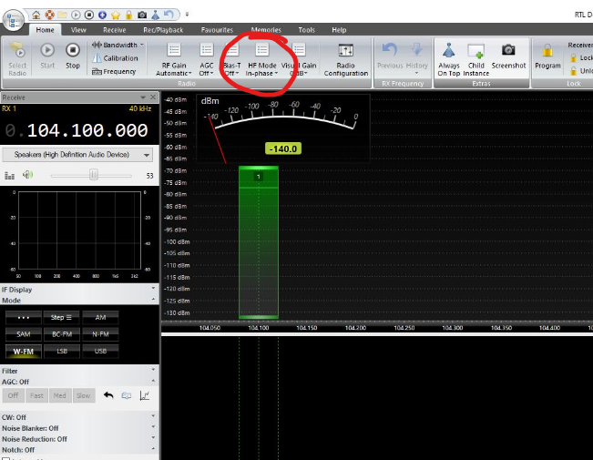

Hi Andy
You are in "HF Mode" mode, used for frequencies below 24MHz only.
Set this to "None" or whatever it is..... sorry, I forget at the moment, but it's the top option. All should come alive.
Hope this sorts it.
