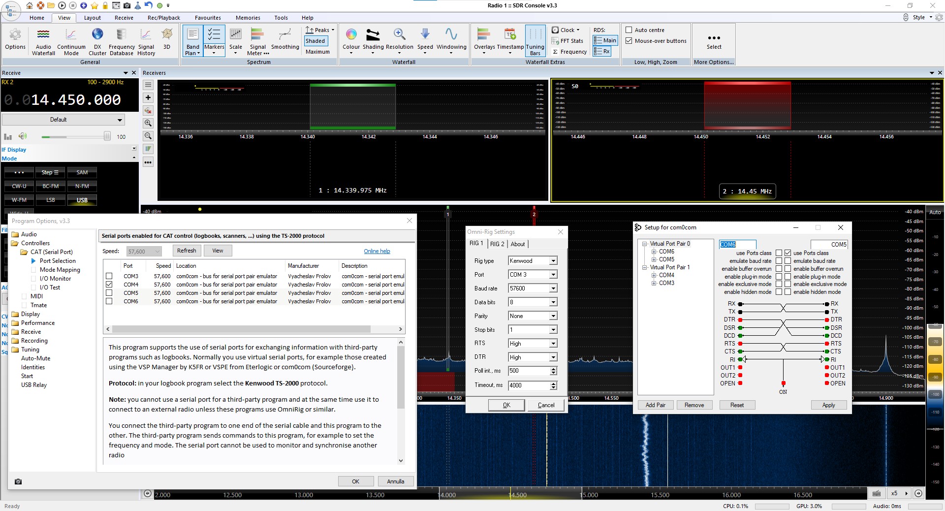

Good morning everyone!..I'm trying to use 2 instances of SDR Console connected to 2 RSP1As (and obviously to 2 different antennas) with Log4OM2 via Omnirig and related serial ports emulated via com0com
At that time....
launching the first instance (first rsp)Log4om2 correctly recognizes the console on rig 1 (serial pair 3-4)
launching the second instance (according to rsp) Log4om2 DOES NOT recognize anything, pairs com 5-6...rig 2 remains with the writing offline
I also tried to make 2 different identities but nothing changes, only the first rsp launched is recognized (com3-4)
another thing I noticed is that using a single instance this is correctly recognized and functioning by log4om2 but when I try to create a second receiver this is recognized by log4om2 as vfo2 (displaying only the frequency in the appropriate box) but when selected from the console the second receiver log4om2 does not "switch" on vfo2 as happens with sdruno...

I solved the main problem of the 2 instances by creating 2 identities (each of which linked to its own radio) and putting simply "keenwood" as the protocol on Omnirig instead of ts-2000... in one identity com 4 is selected and in the ' com 6 is the other... from log4om2 on rig 1 I see the first identity (com 3-4) and on rig 2 the second (com 5-6)

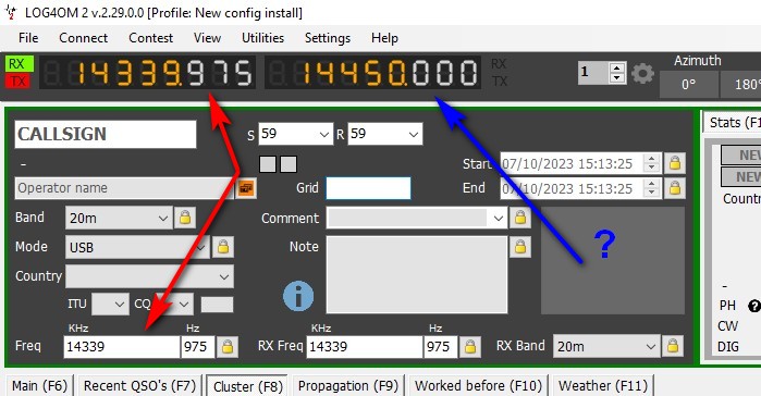

the problem would remain that when I activate a second receiver in the console (within the same instance) it is displayed as a second vfo in log4om2 but is not activated...which is useful for example for the right cluster

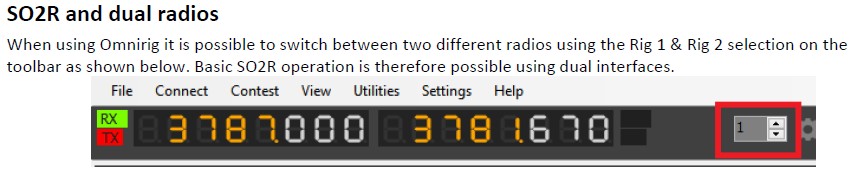

Re: 2 instances with2 rsp with log4om2
See Log4OM operation manual, Page 25 for guidance when operating with two radios. Does that help at all?
https://www.log4om.com/l4ong/usermanual ... NG_ENU.pdf

thanks!. I had solved this, what I don't understand is why when I activate multiple receivers from an rsp by selecting the second receiver Log4Om2 does not translate to vfo b
Apologies. I had mis-read this problem because I answered it from the subject line (two instances). My error.guidomartino wrote: Wed Jan 31, 2024 10:12 pm thanks!. I had solved this, what I don't understand is why when I activate multiple receivers from an rsp by selecting the second receiver Log4Om2 does not translate to vfo b
No, I have no idea. I did not even think there was any functionality at all to display the second receiver for SDRC in Log4OM. I know in recent chats I think Simon said no CAT "per receiver". I don't think it's an intended mode of operation? TBH I just tried this and was very surprised to see RX2 show in Log4OM at all!
Sorry, can't help on this one. If you do find an answer I'd be interested to know.
