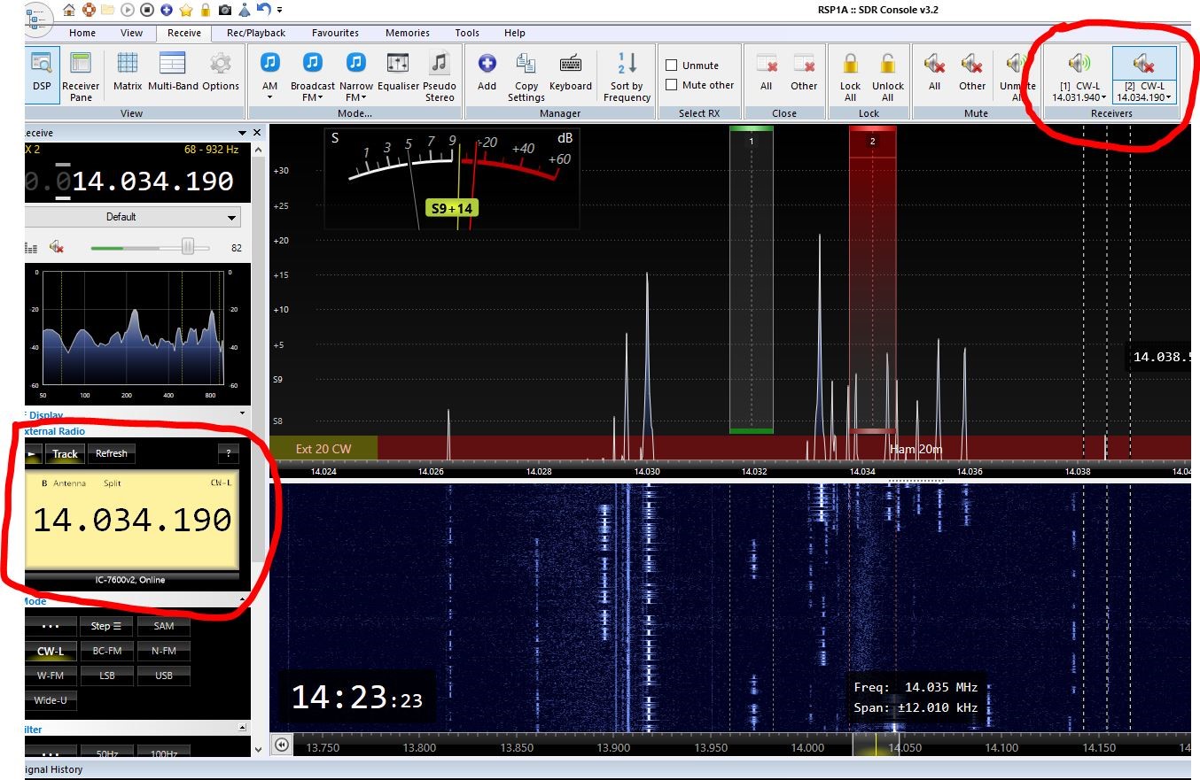

Here is a screen shot of me working split on SDRConsole. You might have to scroll to the right to see all of the image.
SDR Console Split 2.JPG (294.07 KiB) Viewed 8966 times
