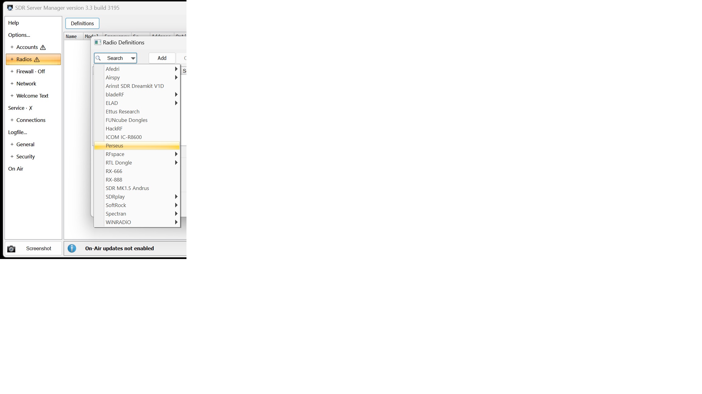

Setting up a new station and PC. I was able to add my Pluto SDR to the Console Application. When attempting same with "Server Manager", I noticed that Pluto SDR was missing as a supported radio from the "add radio definitions" menu. Successfully added and can remote access a SDRPlay device so setup would appear to be generally working.
Anyone know if Pluto SDR is supported on the Server Service? Wondering if I'm missing a step, patch or other tweak or just not supported (darn).

Screen capture of menu

Not supported because Pluto has transmit facilities. The server does not support transmitters (at this time).
