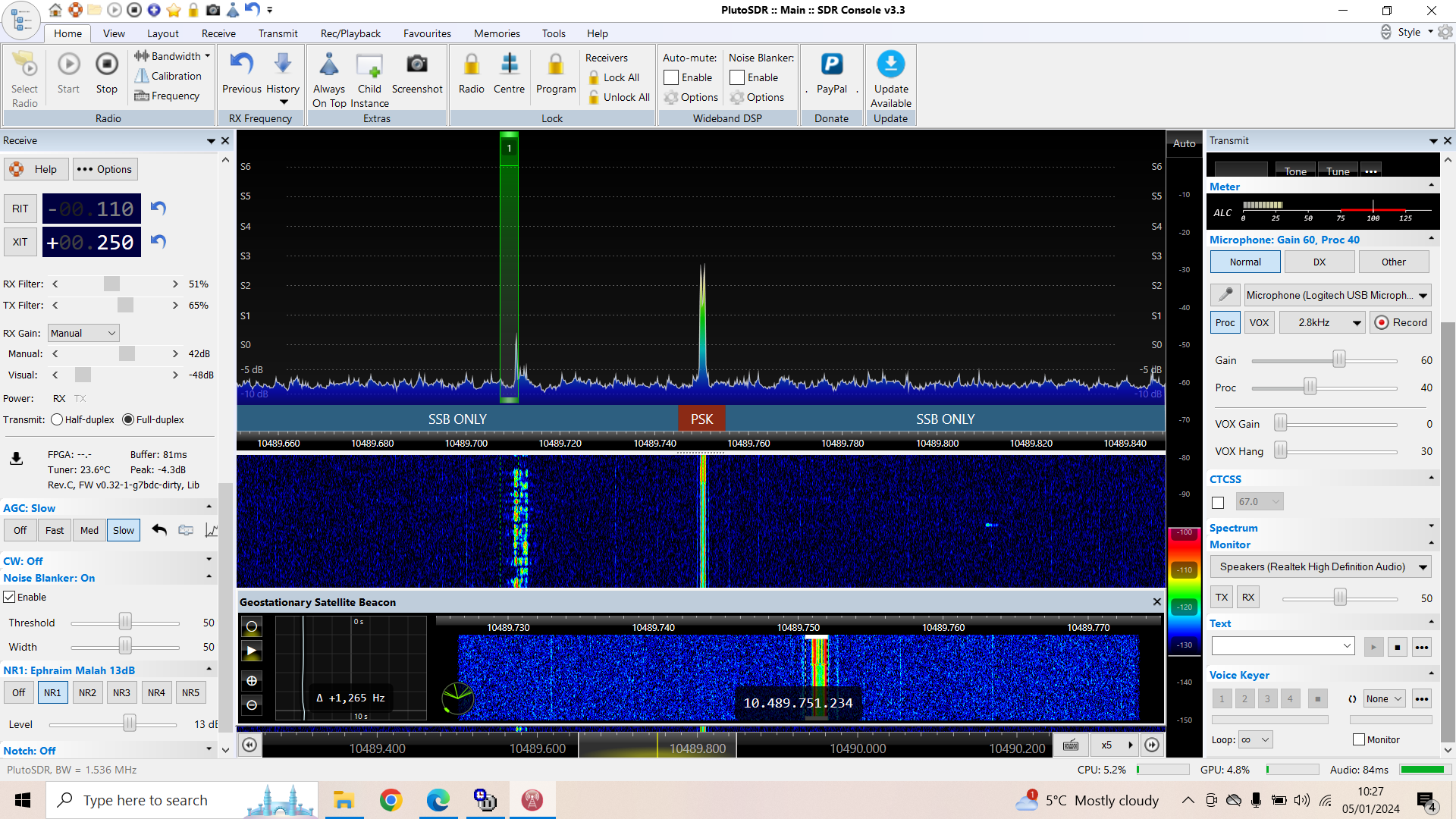

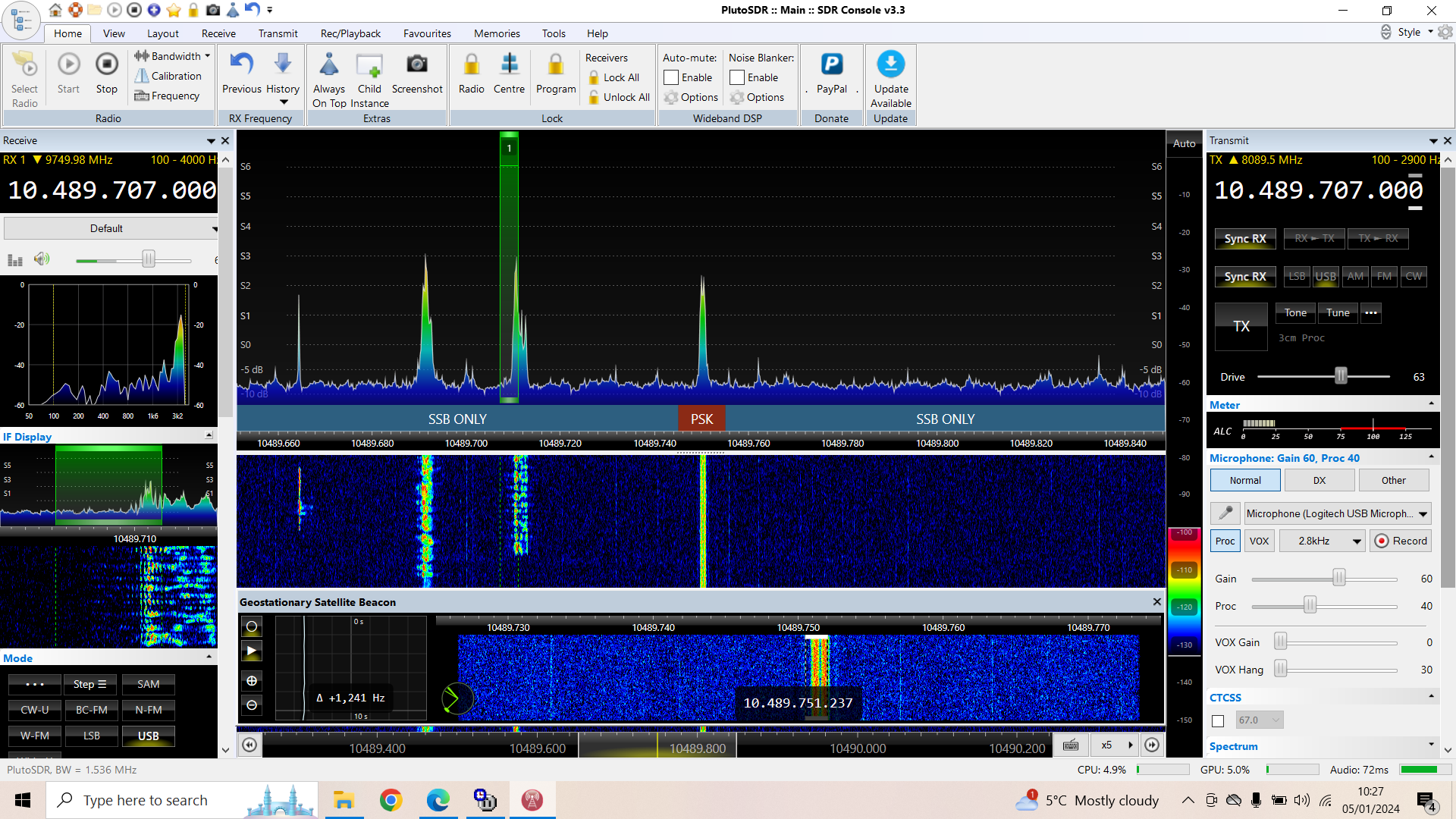

Hi Simon. Thanks for your prompt response and apologies for my tardiness in follow up. Life got in the way. Anyway, I attach a couple of screenshots per your suggestion. Clearly there are many settings in console, so these may not be the pages you need. I looked under TX setting as well under the three dots to the right of the Tone Switch, but could not see attenuation settings there. Or is it the TX filter slider, the purpose of which I haven’t worked out yet?
Many thanks
Andy
