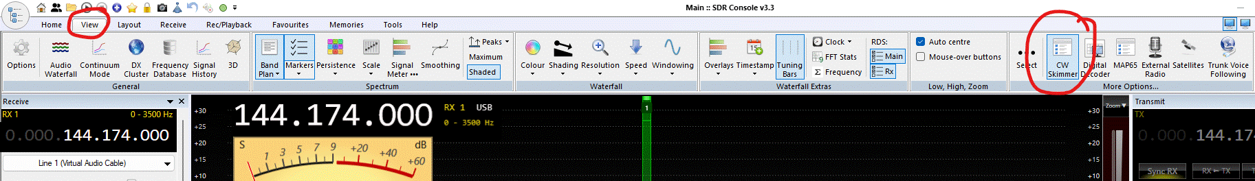

I am not 100% sure this will do what you want, but an IQ output is available from SDR Console by using the output reserved for CW Skimmer via the VAC. Obviously you need to reserve an exclusive VAC for this output:
More information here (but you obviously only need the IQ routing part):
https://www.sdr-radio.com/cw-skimmer
See attached picture to enable/select CW Skimmer output options.

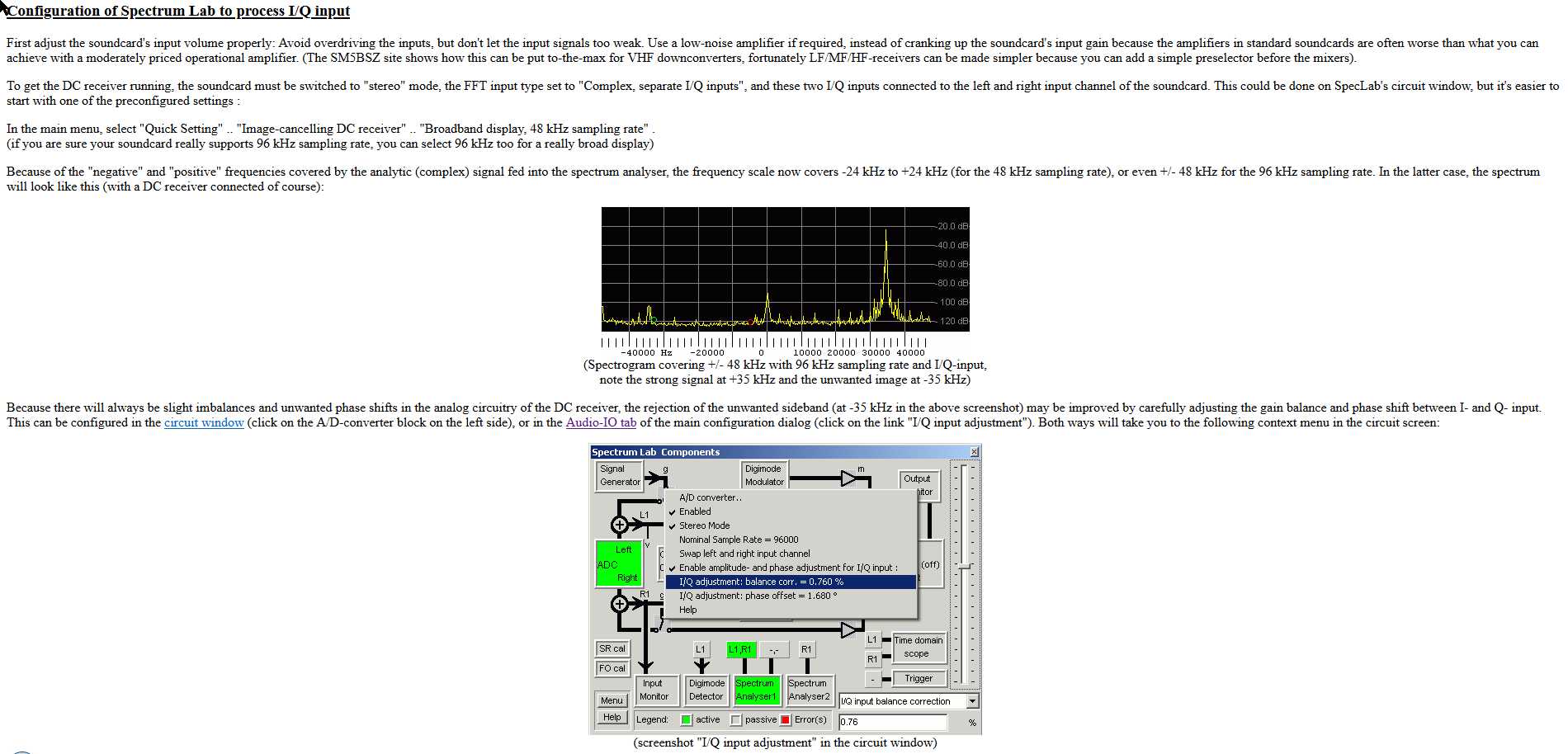

Spectrum Lab expects audio in so unfortunately I/Q samples are not good.

Spectrum Lab can handle I-Q inputs - look through the Help documents
sp6hfe
Posts: 5
Joined: Wed May 29, 2024 6:58 am
Re: How to export wide spectrum for analysis in Spectrum Lab?
Unread post by sp6hfe »
TBH dodn't found that earlier.
Will experiment with that.
Thanks!
