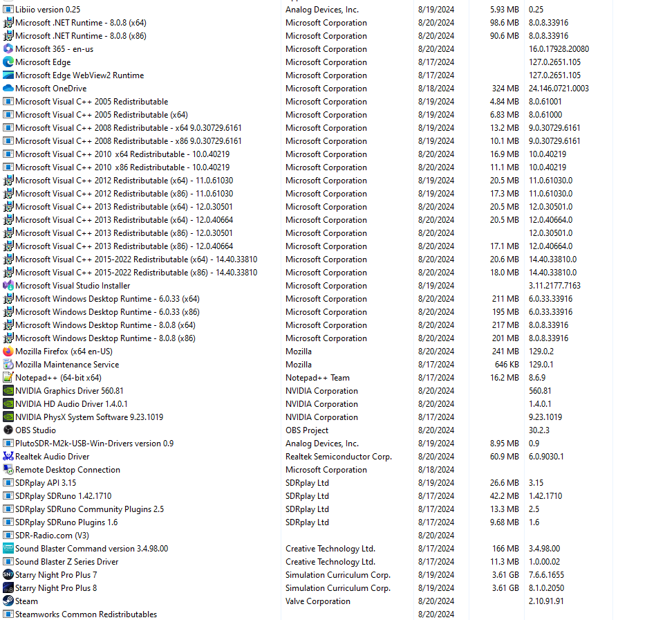

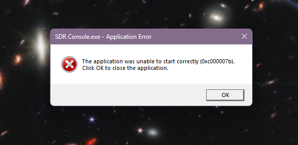

I basically reimaged my system, finally, after I can't even begin to ponder how long. So a new SSD a new install, a new experience right? All goes well, at least I thought so until I go to install my favorite SDR app. It doesn't even load or start, I get greeted with the dreaded error(0xc000007b) one that's normally experienced with the gaming community. I've uninstalled all vsc++ redis's; sdr-console, dotnet, graphics drivers even used ddu. Ran sfc, dism component cleanup with restore, even reset the Window's store cache. Rebooted Installed sdr-console let it do its thing, reboot and bang. Same issue again. Uninstalled it, installed all my drivers, vsc++, etc. Still the same issue, and everything else works without a hitch. I am at a loss here.

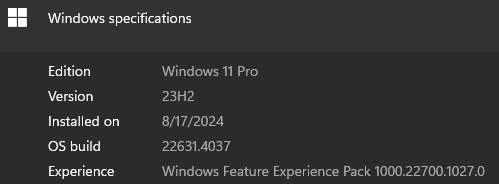

Windows 11 Pro 64-bit operating system 23H2

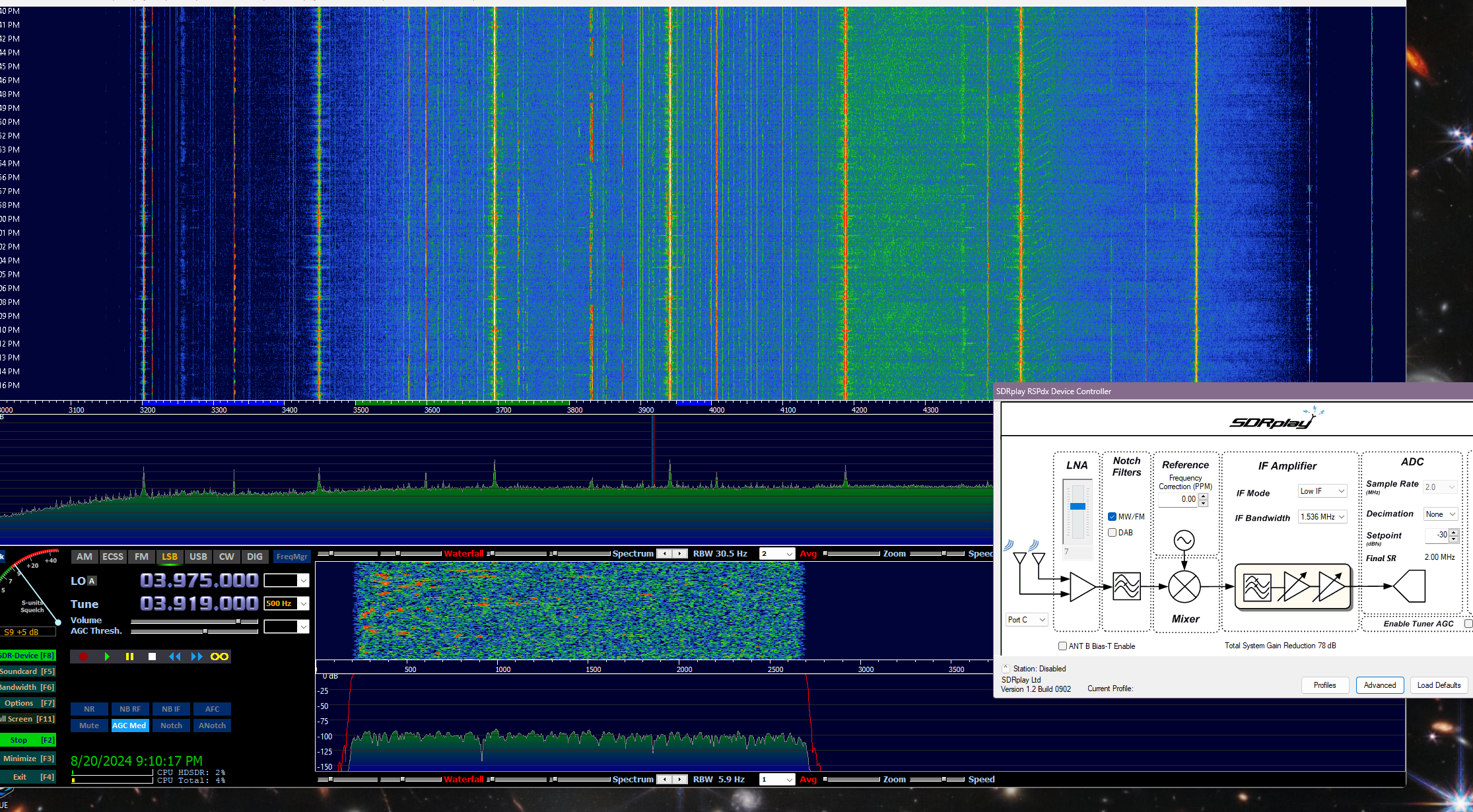

proof system works
proof system works
more specs
more specs
sdr-console error
sdr-console error

My first guess is did you download and install both 32 bit and 64 bit versions of the redistributable files? Are you trying to load a 32 bit version or a 64 bit version of SDRC? I'd select the 64 bit version since you are on a 64 bit OS version. There is a file missing and in its infinite capacity of generating 100% accurate and 99.44% useless error messages we have to guess what is missing.

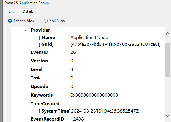

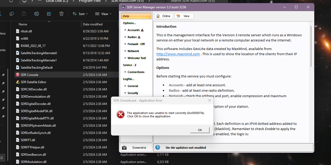

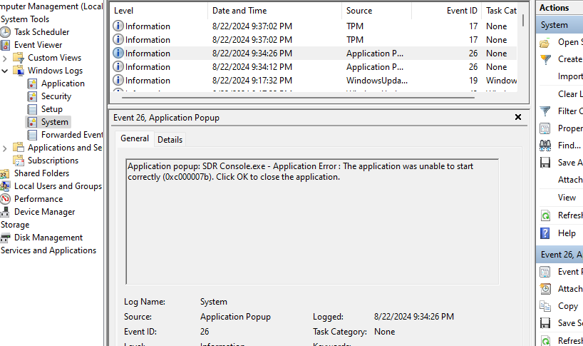

Nope, none of it. Your assumption is correct. What is weird about the installation is it goes through as normal, but there is nothing for it in the user/appdata/local or programdata folders, just program files. I'm boggled (slams head on desk), but I can launch the server portion. I guess that's a good lead, I dug into the event viewer to dig for something, and yup. I appreciate the help and pointers. Thank you.

Well good news is I got it all working. Shocking thing, it was bad RAM, not an SSD issue. Anyhow my situation is fixed but was a serious bit flipping condition. :lol: It was in the upper DIMMS which sucks and I wouldn't have noticed unless saturating my memory since I'm running with 32GB. Dam power outages will do it. And yeah it will ruin UPS/BBU's which I've lost to them. Just Glad I can use SDR - Console again.
