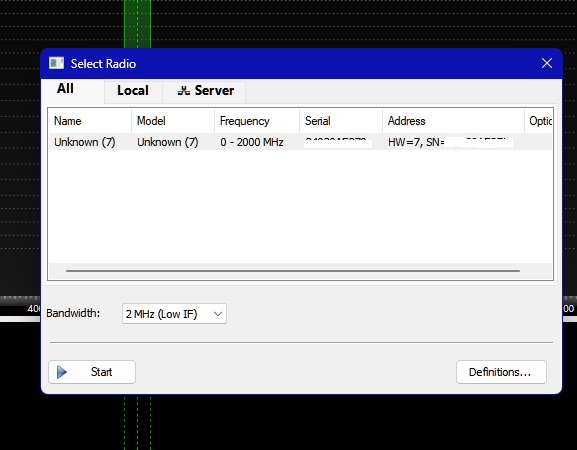

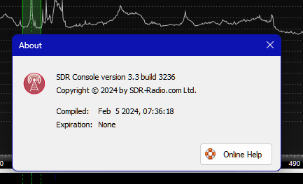

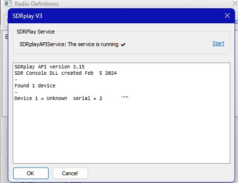

Hello all. I'm hoping someone can point out what I'm missing/doing wrong. I have SDRuno V1.42 1710 installed, and it shows 3.15 API. Console is the latest Build, see pics below. SDR Console works with the radio, but it shows as "unknown", and features like antenna choice, IF/RF gain are missing, just the basics. Any ideas? Thanks

Max, thank you. I was getting ready to post this in that forum. Also, the Server does not work, most everything is grayed out

He responded to me on that other list, thanks, and that worked like a charm
