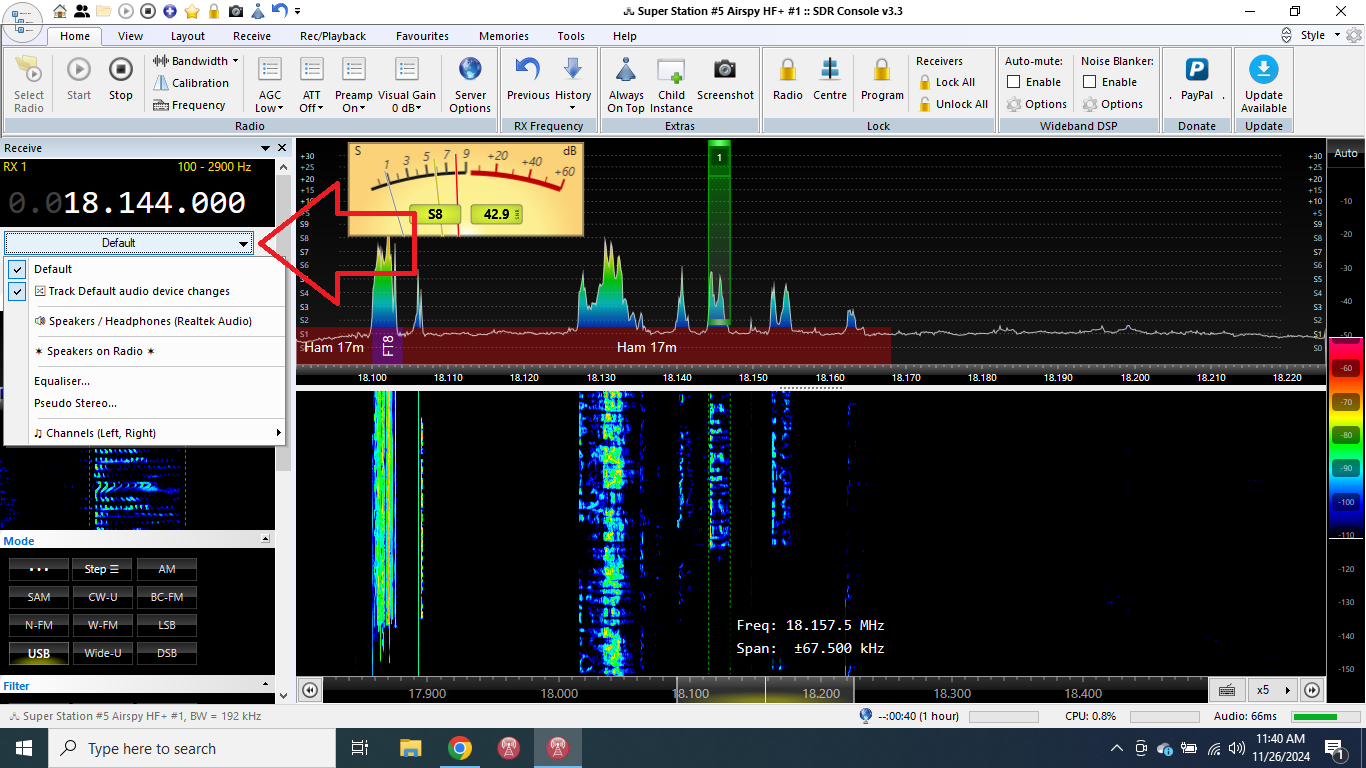

New user as of today. Where do I go in v3.3 to change the audio output from default (speakers) to another destination? Also, is there a virtual cable that works well for connecting SDR Console to WSJT-x?

In the DSP panel, under the frequency readout.
See atached.
Audio Choices
Audio Choices

Keith, audio selection as per Kriss's screenshot, in the RX DSP panel. It's possible you might not have the DSP panel showing. Call this up in the Ribbon Bar (the strip of options at top of screen)
Receive Tab > DSP (button on extreme left of the Ribbon Bar)

Re: Routing output audio from v3.3
If you have several "receivers" (see Receiver panel in ribbon bar) the active one gets its audio redirected to the port you select. Different receivers can speak to different audio ports.
