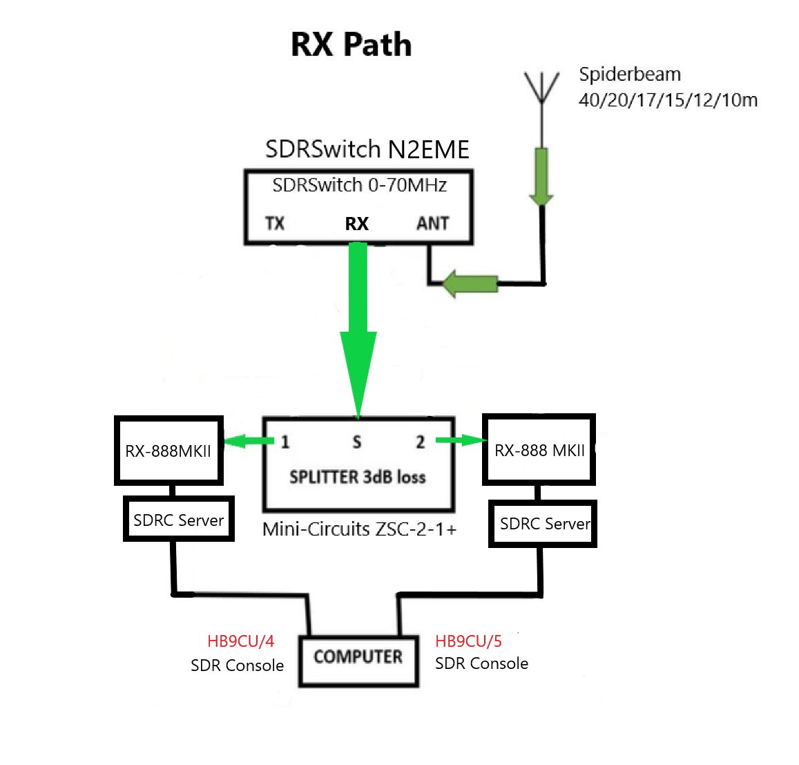

Here is an attempt to find the best settings in SDRC by comparing WSPR decode performance. This is my test setup

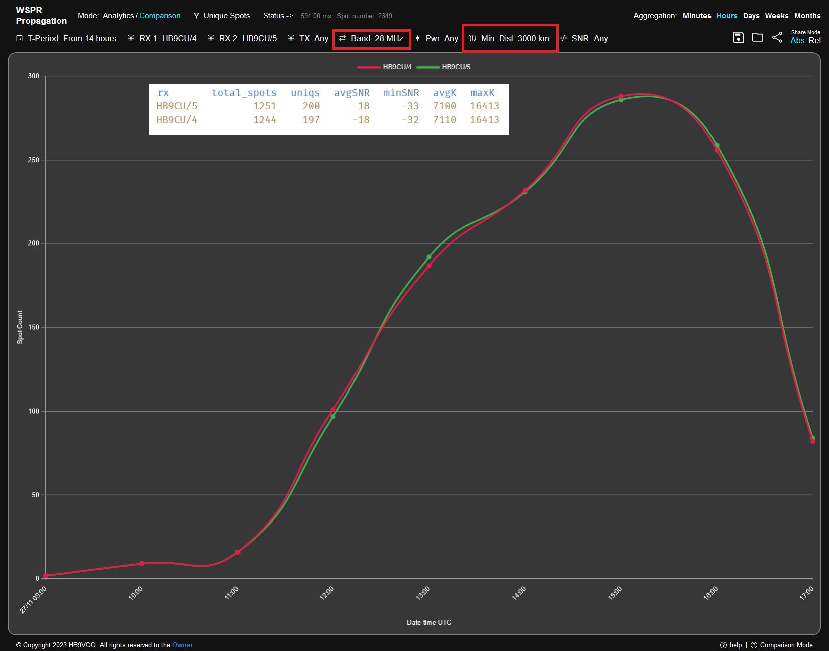

First, I created a baseline to see how much the DX (Spots > 3000 km) WSPR decodes differ from each other with the same SDRC configuration during 10m band peak propagation
Deviation < 1%

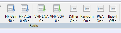

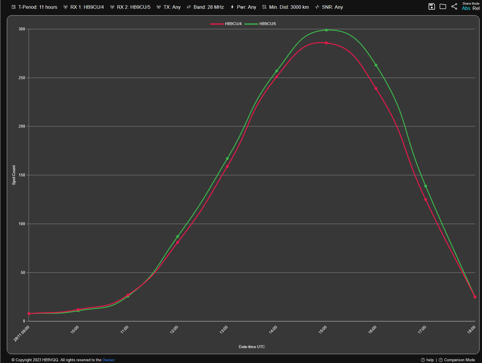

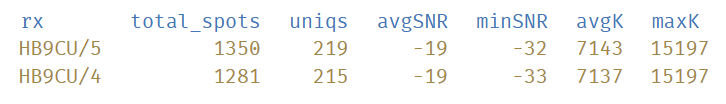

I changed the gain setting (HF Gain) on HB9CU/4 from 50 to 20 dB, which degraded the decoding performance by about 5%. No settings changed on HB9CU/5
Next, increase the gain on HB9CU/4 to 70 dB and see if there is any positive change in the number of DX decodes.

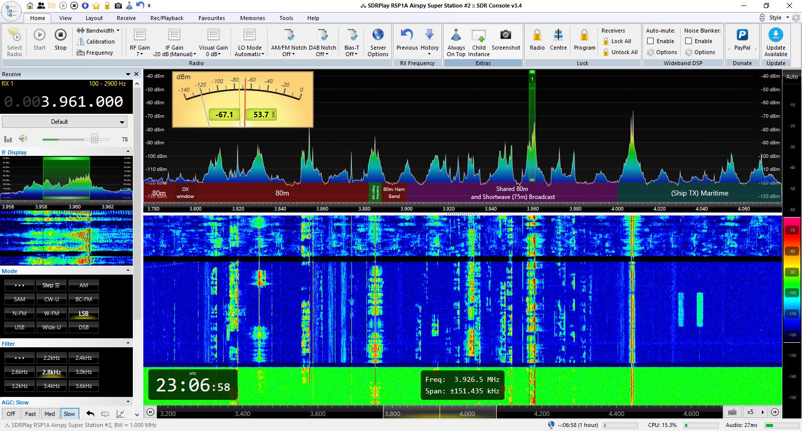

On a similar note, the SDRPlay "RF Gain" numbers (0 to 9) have weird effects. In the attached image I went from a RF Gain level of "3", "5", and "7" in that order. One would think the noise floor would be highest on the "7", but the noise floor is -98dBm on "3", dropping to -120dBm on "5", and further dropping to -121dBm on "7" (along with all the AM BC garabge/products).
I don't think there's a correlation between gain numbers and 'real gain'.
- RF Gain 3,5,7 while QRV 3961kHz...
- Screenshot-2024-11-30-180658.jpeg (331.12 KiB) Viewed 38204 times

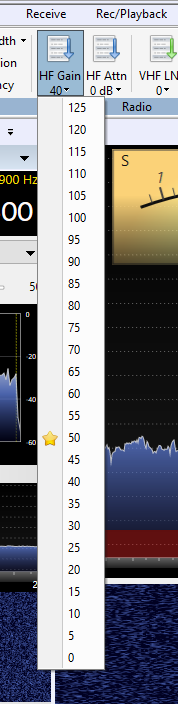

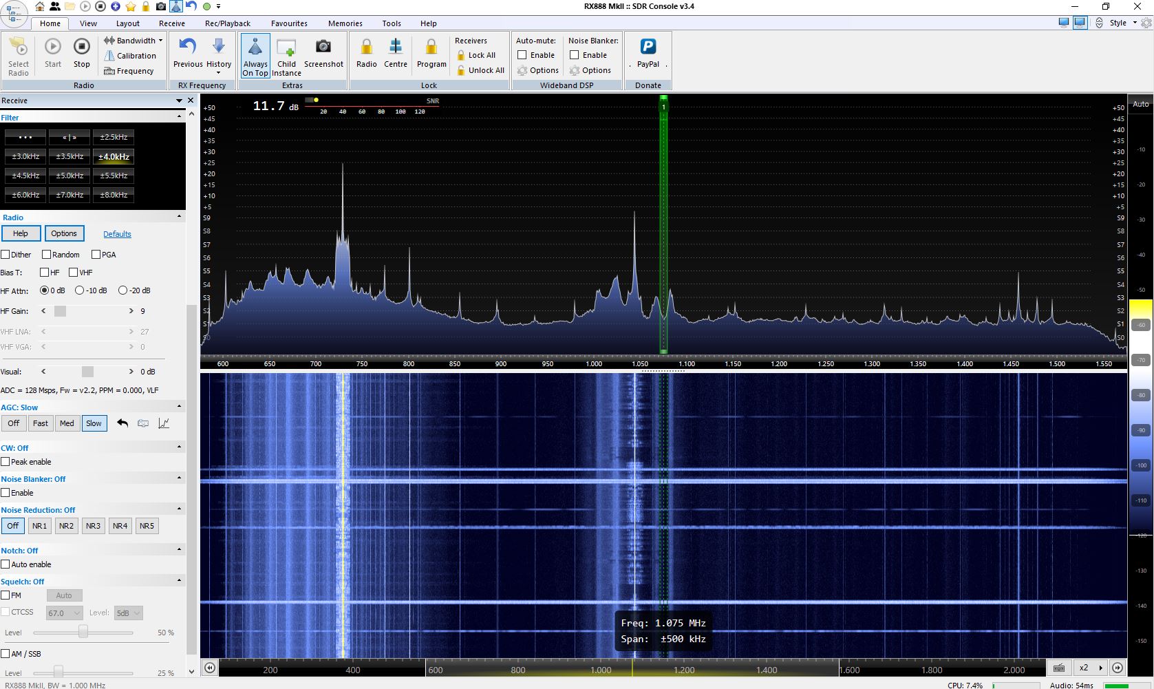

I still wonder how the HF Gain in SDRC influences the gain level of -10 to + 33dB of the RX-888 Mk2
Re: FInding the best SDRC settings for the RX888
Considering there is no HF Gain within SDRC.... That menu item you see is the RX888 MKII gain.
