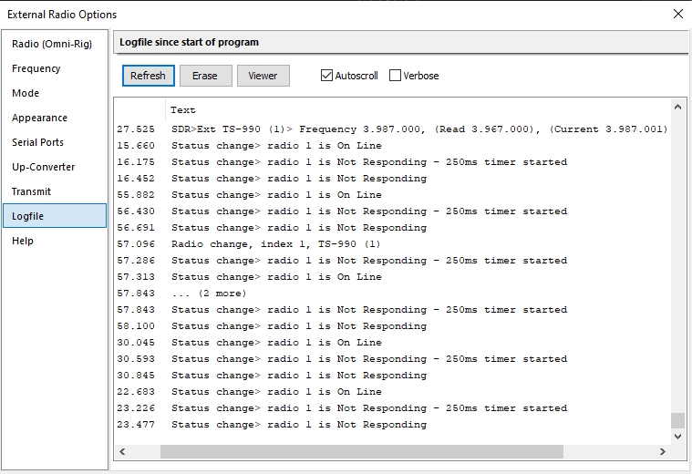

For no apparent reason, the External Radio window today is reporting "Not Responding" but this is only partially correct. My initial attempt to change frequency via SDR-Radio does not work as previous, but after some seconds of delay, the radio does in fact track to the new selected frequency / mode. This is accompanied (if I change bands via SDR-Radio) with the radio notification (CW tone) that follows an external command to indicate a status change has occurred.
I would say the delay to go to the newly selected frequency is about 3 - 4 seconds maximum, however sometimes the change is less and even instantaneous. All the time, the External Radio window reports "Not Responding". And now, frequency changes are one way: a change to the radio does not change the SDR-Radio status. I have not tried transmitting to make sure the mute function is still working as it should. I can confirm the polling delay within OmniRig remains at 100 ms.
Obviously, hoping for some ideas on this one. Partial log file attached.

As you see from the logfile, the External Radio status changes (ever so briefly) to On-Line without any
intervention from operator and then quickly to Not Responding.

I wanted to let you know that I reverted to the 3.3 Release version as mentioned. There is no change
in the External Radio behavior. The logfile looks very similar with the "Not Responding" giving way
to "On-Line" every so often, for about 1/2 second or so.
I expect I will have to look next to Omnirig and perhaps go to v1.20 and see if that is the culprit
