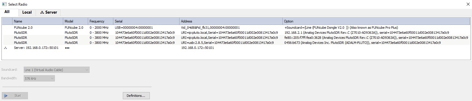

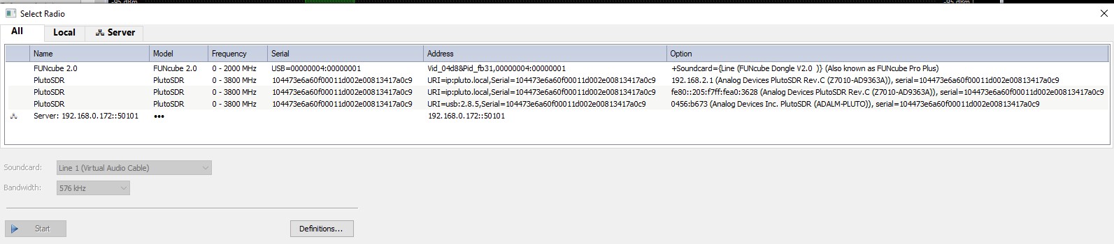

Interestingly, the instances shown at failure, and those that replace them after a search and replace appear to be identical.
Attached Capture1.jpg = at failure.
Attached Capture.jpg = after search and replace.

Note that the "Select Radio" window you see is showing the "All" tab, which includes both Local and Server connections. The server listed is on another machine on my network that is located remotely over a wifi link. It has nothing to do with this issue. The FUNcube 2.0 definition is not used at the moment because the FUNcube is not plugged into the machine.

Now, nothing is grabbing onto the Pluto if all you have to do is remake the definition. I presume the definition is getting saved because I believe it must be saved before SDRC allows you to connect to it. But, you say you must refresh the definition if you merely stop the DSP and restart it without closing SDRC. Take a picture of the select radio panel just before you connect. Then compare what it shows to what you see when you bring up the select radio panel but before you refresh. Are they the same? Then refresh the definition and check against the saved data. Are these the same? It almost sounds like the Pluto's firmware is giving you different numbers every time or somehow you are not having the definition properly saved. That should not happen. And in a dual Pluto station that could make it impossible for you to consistently open the desired Pluto.
