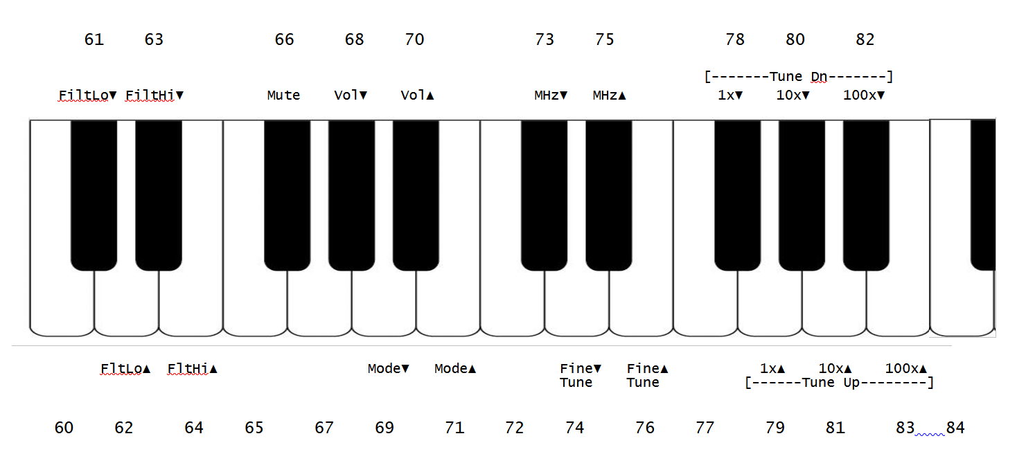

Attached to this post is a SDR Console XML file that turns a MIDI piano keyboard into an SDR Console controller. Two octave keyboards are plentiful and cheap, and some may be more durable than DJ Controllers. I've set up all of the usable receiver commands in two octaves, from Middle C (note # 60) and up. A bigger keyboard will work, too and could be used to most easily implement transmit commands. I hope this is useful.

Keyboard layout with MIDI note numbers
