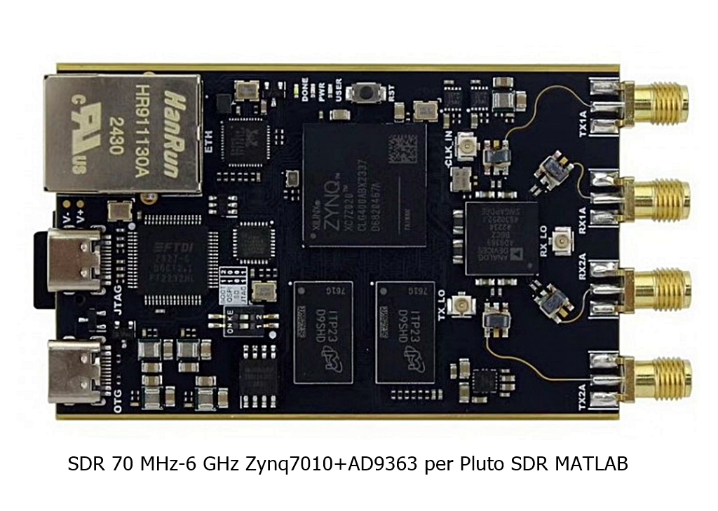

Hello Friends,
Anyone of you use the card like this SDR 70 MHz-6 GHz Zynq7010+AD9363 with the SDR- Console software ?
Is it possible to manage the 2 RTX channels independently ?
I would like to use it as an RTX driver for an HF radio with IF at 72 Mhz on channel 1
and for the other higher frequencies VHF-UHF-SHF on channel 2 of the SDR card.
Suggestions ? Thanks !

IK2NBU wrote: Sun Mar 16, 2025 7:51 am Anyone of you use the card like this SDR 70 MHz-6 GHz Zynq7010+AD9363 with the SDR- Console software ?
Arnoldo, the picture shows the Zynq7020 version?
Simon is working on similar board at the moment, particularly for DATV:
https://www.sdr-radio.com/libresdr
https://www.sdr-radio.com/libresdr-revisited
As far as I know there's no plan to use the dual RTX channels. He has certainly not mentioned it.

Without designing it from the git go as a dual channel SDR it's VERY difficult to make an single front end channel SDR into a multi-channel front end SDR. In the past Simon has indicated that this is not in the cards.

I see that with SDR Angel Software + MIMO Plug In made by a France OM, maybe is possibile use 2 Channel RTX in different bands.
But SDR Angel and Plug MIMO is not easy to use.
