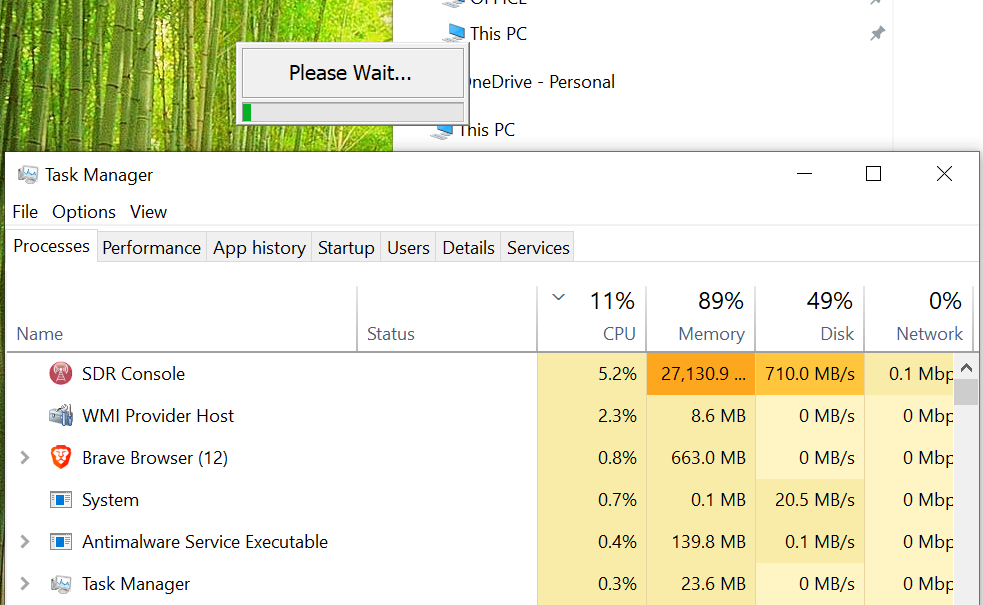

SYMPTOMS
1. When SDR Console window remains minimized, the memory usage continuously increases. It can reach insane levels of memory usage until the application can stop responding or crashes.
2. Restoring the window causes very high disk activity for a long time, as the memory is slowly released.
3. An unusual GUI message box may be displayed containing the text "Please Wait..." and a progress bar.

Screen recording showing SDR Console memory usage increasing over time, when SDRC is minimized:

I passed a note to Simon about this one. It puzzles me that it happens for you and nobody else has noticed before.
