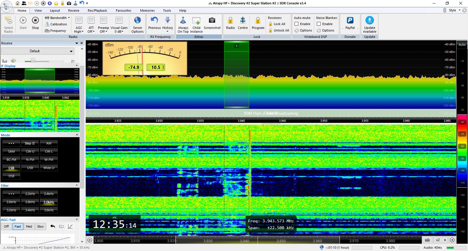

I have powerline arcing once the lines dry out, and it makes the lowbands nearly impossible to RX during the daytime. Actively chasing it down with my RDF loop antennas and have it narrowed down to my neighbors driveway where there are at least two power poles, and one transformer. Once I get permission to walk up the driveway and locate the exact source, I'll advise the electric company of their issue. It's arcing randomly, with long stretches of continuous arcing... so at times it's hard to get a good fix on it.
This is 80m this AM a few hours after local sunrise:

As it turns out, the neighbor is having the electric company out this week to connect a new service to their barn. I called it in and created a "ticket", so they may possibly fix it when they come out for the service drop. I have it narrowed down to a single pole, where a single 7200V line sits atop the pole. There's a wire wrap and insulator up there only. I have had wraps go bad before showing up ONLY during daytime, dry conditions (opposite of cracked insulator). This one started out very intermittent, but now it is continuous last night and into today and we had mist/dense fog last night and it's still very damp.
Peak noise is in the the 3.8 to 4.5MHz range, S-8 (-80dBm).

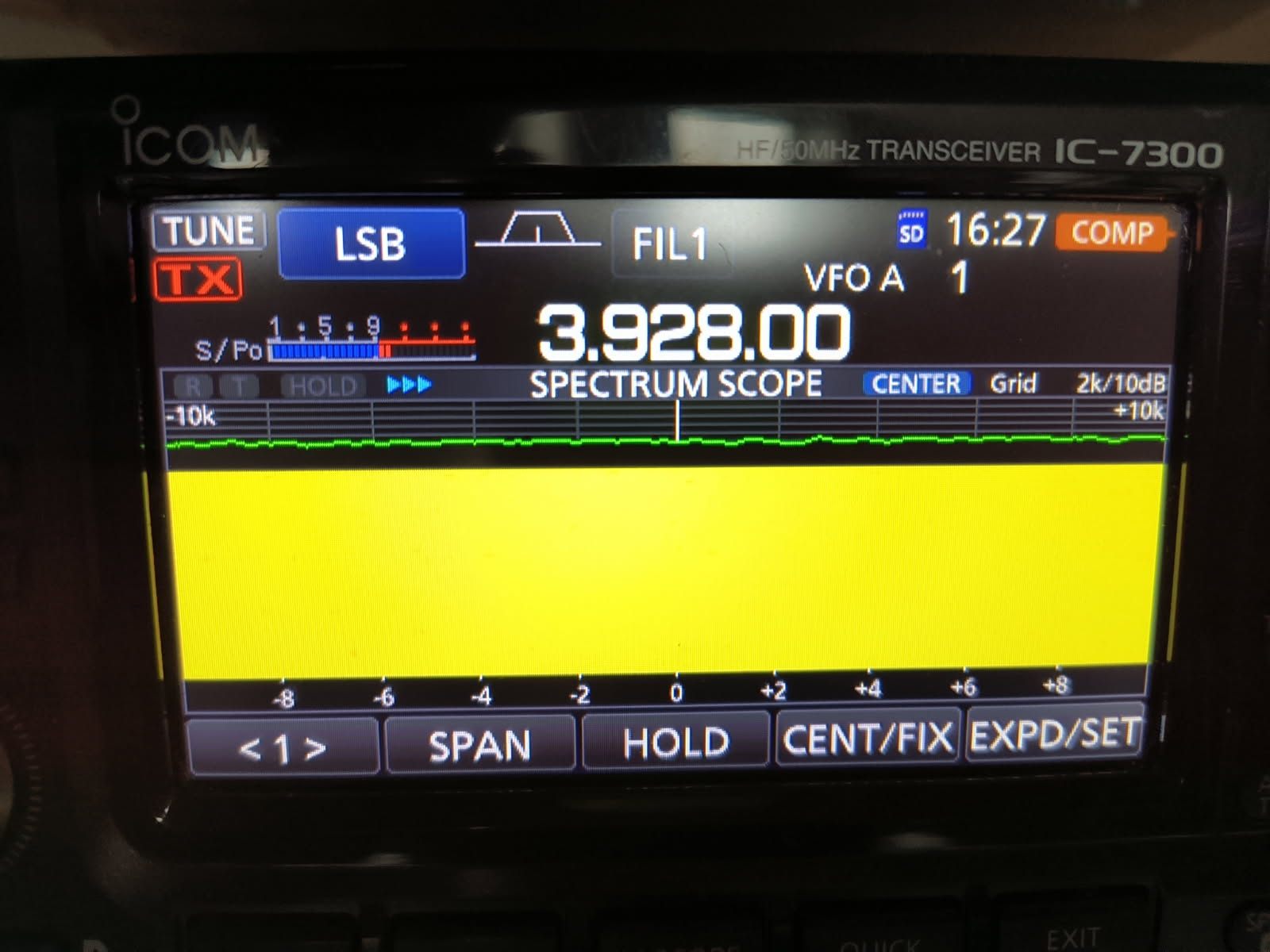

Here's what it looks like on my IC7300 with a resonant 75m antenna about 500' from the pole.
That's an S9+10dB noise!
