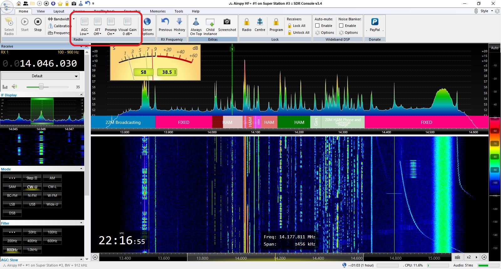

You should see the AGC, ATT, Preamp, and Visual Gain buttons in the 'Radio' section of the home tab. See attached image.
Typically AGC on Low or High (doesn't seem to matter), ATT OFF, Preamp OFF (or ON if on 20m and higher), and Visual Gain of 0dB.
The lastest version is 3.4 and you can download 3.4 beta, dated February 10th, 2026 Build 3972 about 3/4 the way down on the downloads page of the website sdr-radio.com
What antenna system are you using, ie coax length, type of antenna, balun(?), unun (?), CMC(?), etc.
For example in the attached photo, I have the Airspy HF+ Discovery, +170' of RG-213, 9:1 unun, and an inverted L going up about 60' and horizontally about 100'. Counterpoise directly under the antenna of +150' made from repurposed galvanized cattle fencing wire. Grounding the unun with a 3/4" copper pipe gives me a 1.5 S-unit drop in noise floor on 160m, 1 S-unit on 80m.

- Screenshot-2026-02-20-171656.jpeg (463.24 KiB) Viewed 242713 times
