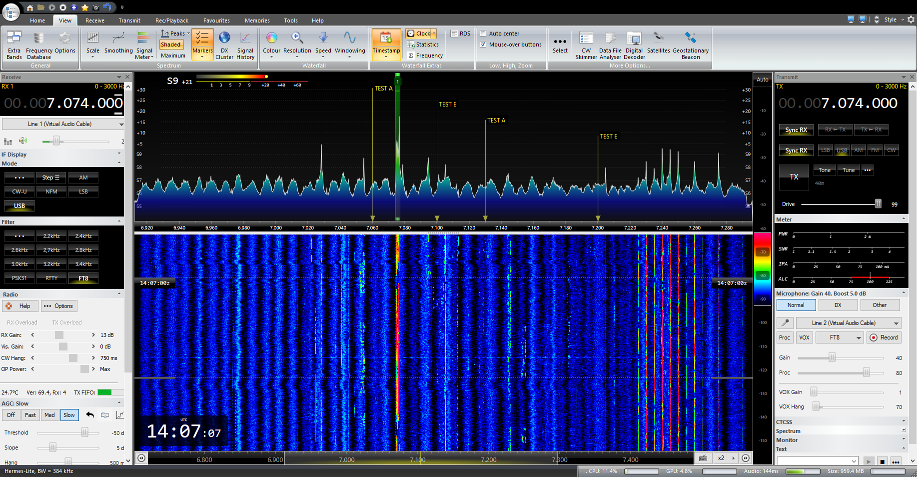

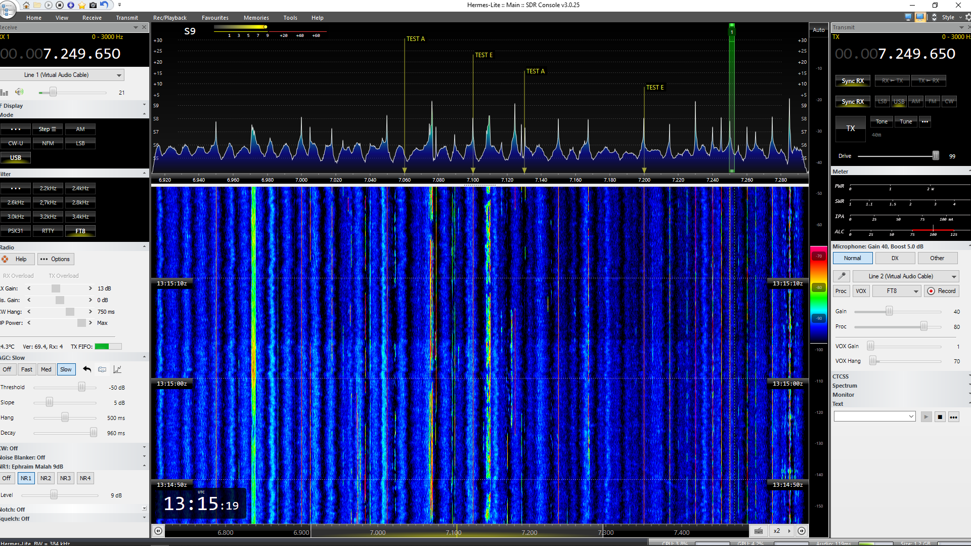

just installed the .25 Version and have some issues which i can't remember having them with the .24.
Whenever i maximize the console window to monitor 1 or monitor 2 with the little monitor icons in the top right corner, some parts of the window are invisible. It seems that there are outside the visible monitor area.
Monitors are both 1920x1080px
Please take a look on the following screenshot.
When i maximize the console window by double clicking the title bar i had some strange artefacts which were shown over the left and right sidebars. But not always. had it two or three times only.

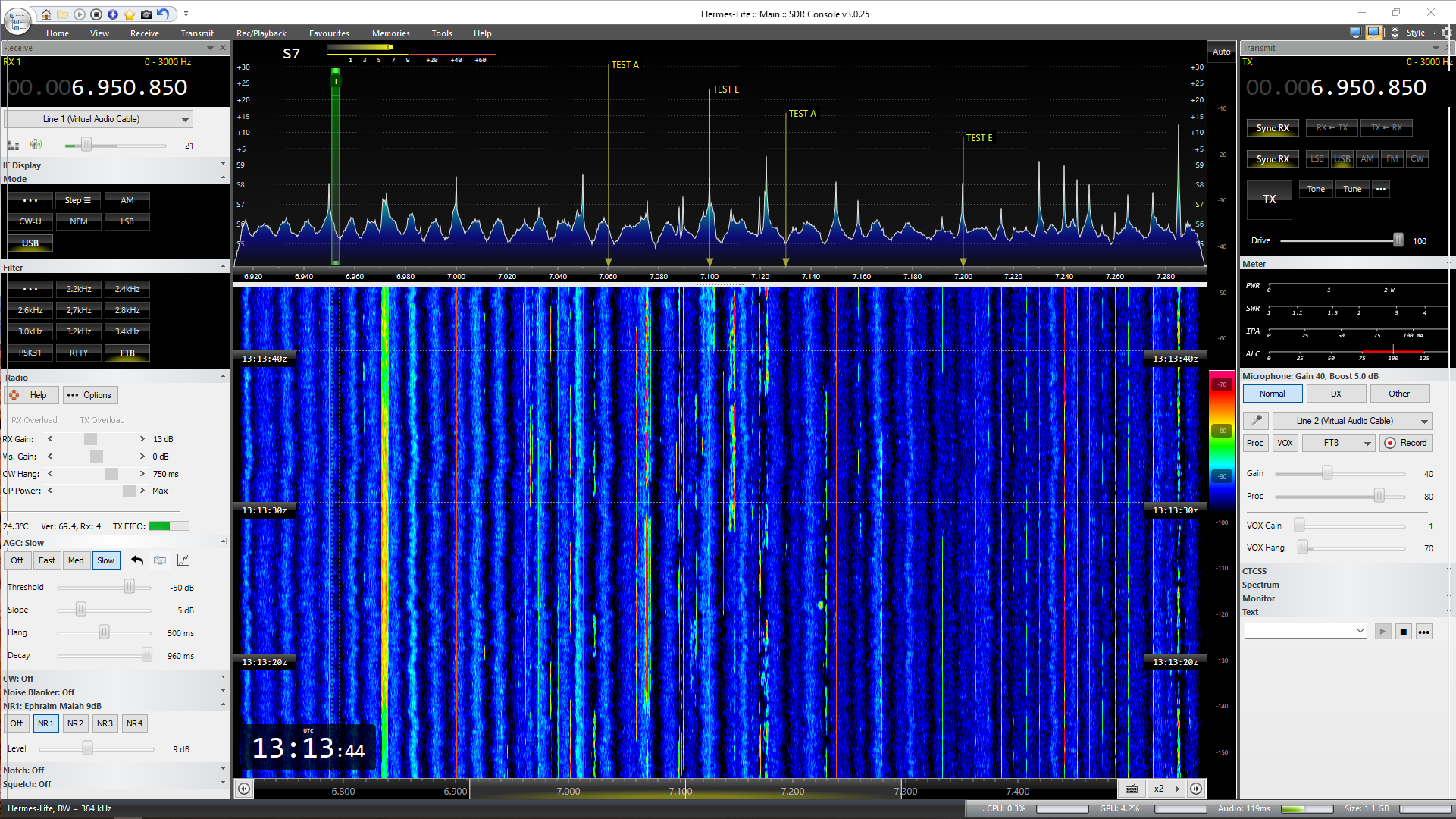

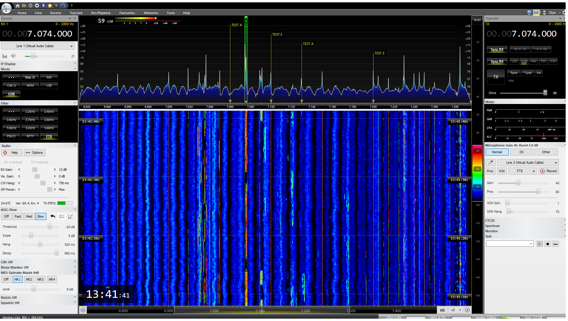

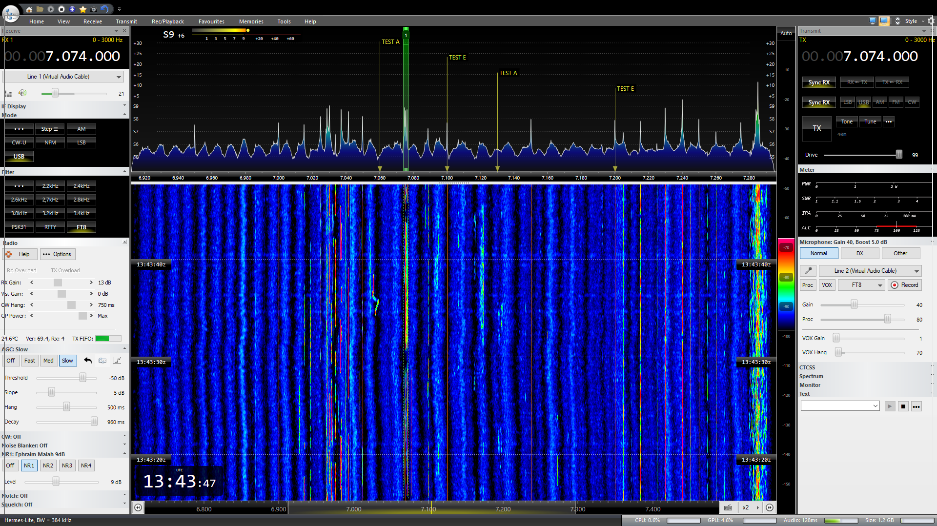

i've retaken the screenshot with the internal tool. I had taken it with snipping tool as it better showed how it looked on the screen.
Again. this one shows the cropped view:
This one shows the weird overlays:
Attached the dx diagnostics result.
