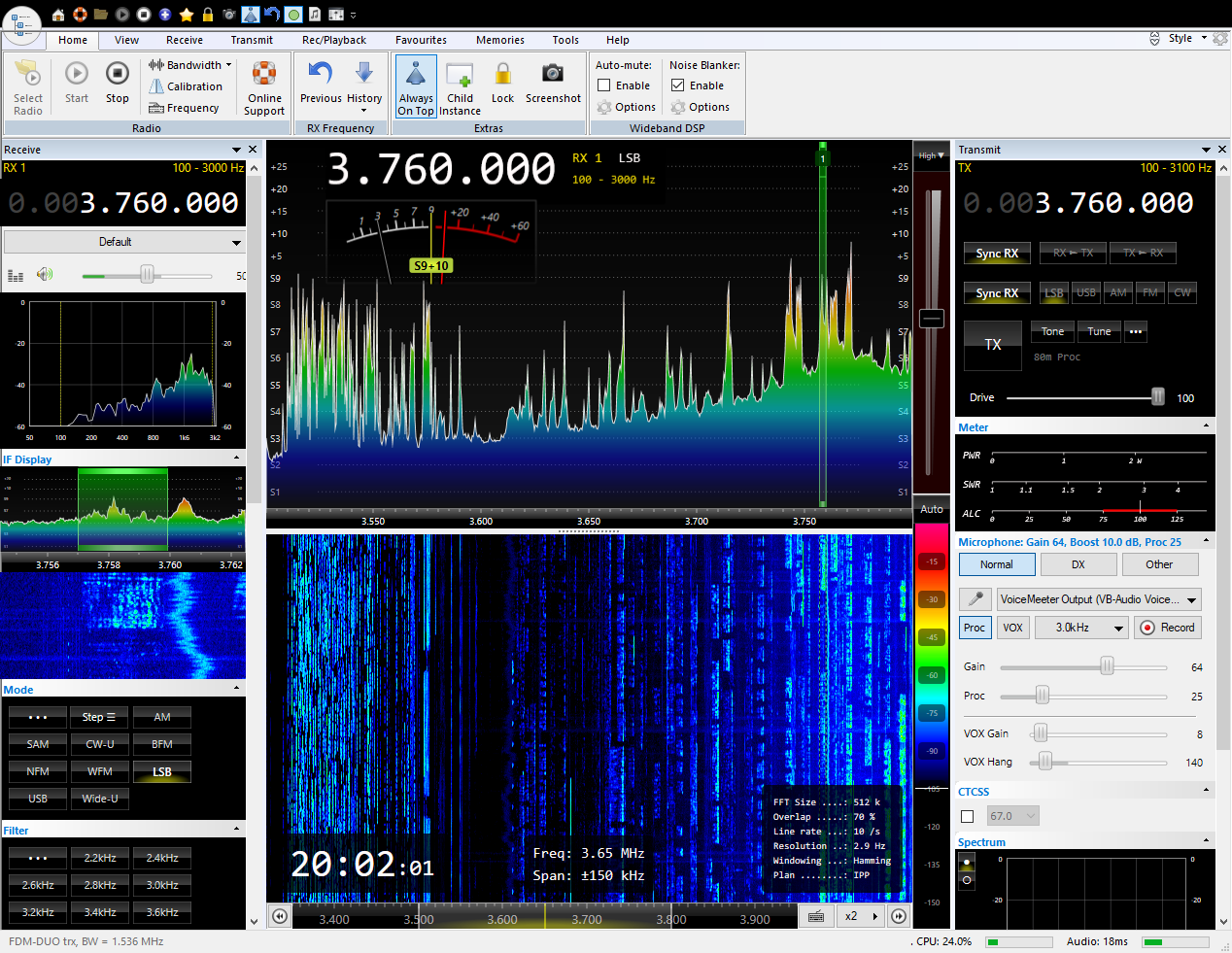

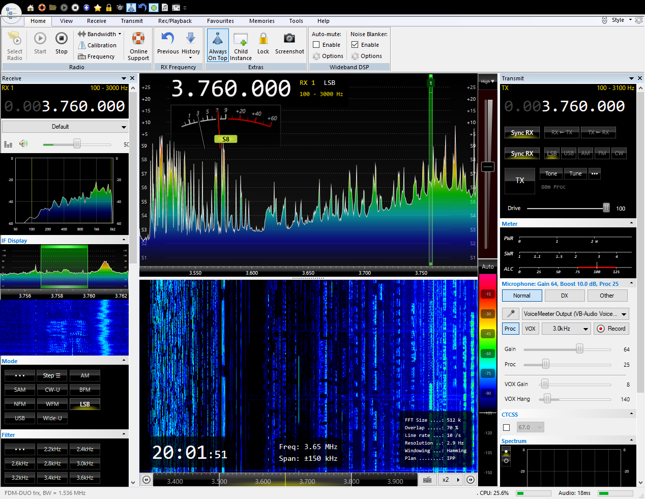

ok..that didnt go to plan..i opened some windows, but they closed as i hit screenshot button. AND will not allow me to screenshot open windows..ie performance...
elad is running on 1.536 mhz bandwidth.audio in is via vb bananna (as using the noise gate function, but makes no difference if i use mic in via realtek.
Audio in is via wired headset into mic in on pc.
Re: Help with tx latency elad duo
Mic is going via Voicemeeter. That will add delay. Any reason not to select soundcard mic input direct to SDRC audio in instead of via Voicemeeter? I would guess it is to raise mic level? By the way, I do the same thing with HL2 to get enough audio drive. But if this is the reason I think you have more mic boost available within SDRC? Another 10dB, instead of using Voicemeeter?
Also, take a look at this if not already familiar. Audio card driver choice (if there is any) can make quite large differences to the latency:
https://www.sweetwater.com/sweetcare/ar ... me-drivers
Use ASIO whenever possible.
