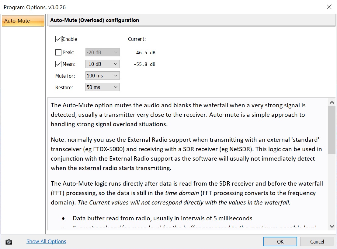

I Have the mute function set for strong signals, however I do not believe it is working correctly or there is an operator error. I have the RSP1A and a Yaesu FT1000MP with the pandadpter board installed. When I transmit I get the huge signal and lots of feedback from the speakers. Is there a way to kill the receiver or mute it when I transmit.
Thank You
Chuck N5ANY
Posts: 2174
Re: Mute PC/SDR
Screenshots always help. Wideband DSP is the easy way to do this:
Ribbon Bar, Home, Wideband DSP, Auto-mute.
