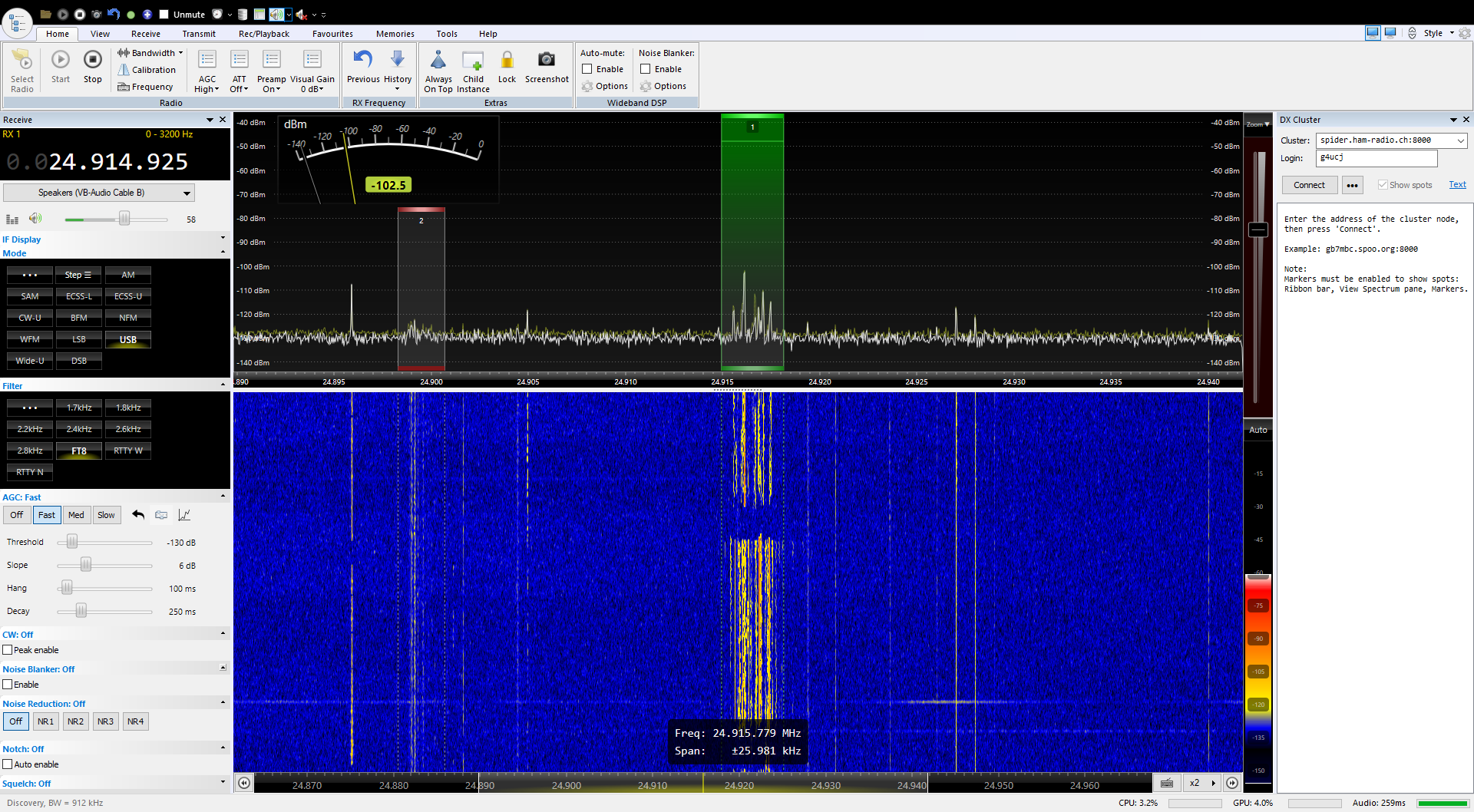

I've attached a screenshot showing the quick access toolbar. Towards the right of the bar, there are icons for the two active receivers. I use this to quickly switch between the two, in a similar manner to what you may do on an HF transceiver, switching from 'VFO A' to 'VFO B' or vice-versa. This remains active and working how it should until I next restart the console. One it has restarted, I have to redo the quick access customisation for the receivers.

Active receivers re not going to be sticky, sorry. I'll look for a better solution.
