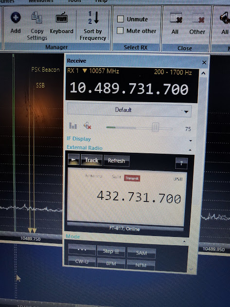

I'm trying to set up SDRC for CAT control of my FT-817 to work QO-100. I've followed the setup instructions at https://www.f5uii.net/en/control-transc ... eshail2/9/.
The screen says the FT-817 is "Online" and when I change the rx frequency a new tx frequency appears in the External Radio box, but the frequency on the FT-817 does not change at all.
Any idea what may be wrong? How to fix?
Thank you and 73, Bill

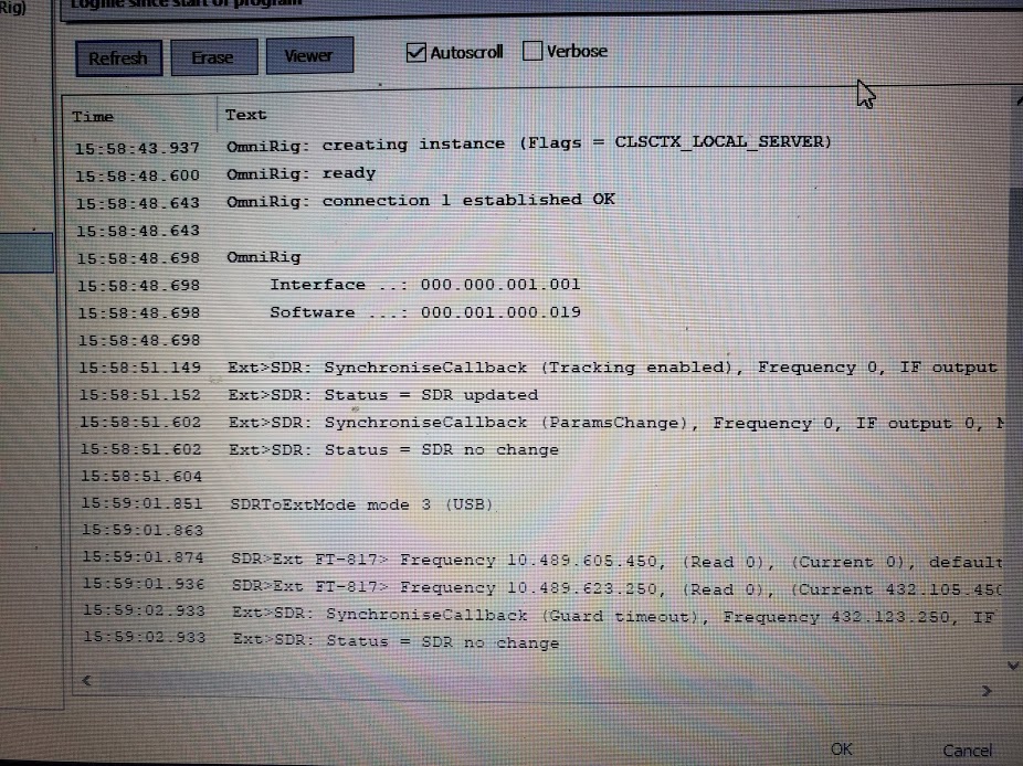

Attached is the log file, does the "Guard timeout" message mean anything?
73, Bill

Please save the logfile and attach so I can read it.

Simon G4ELI wrote: Sat Oct 24, 2020 8:38 pm Please save the logfile and attach so I can read it.
Thank you very much for the reply, Simon. The log file is attached.
73, Bill
