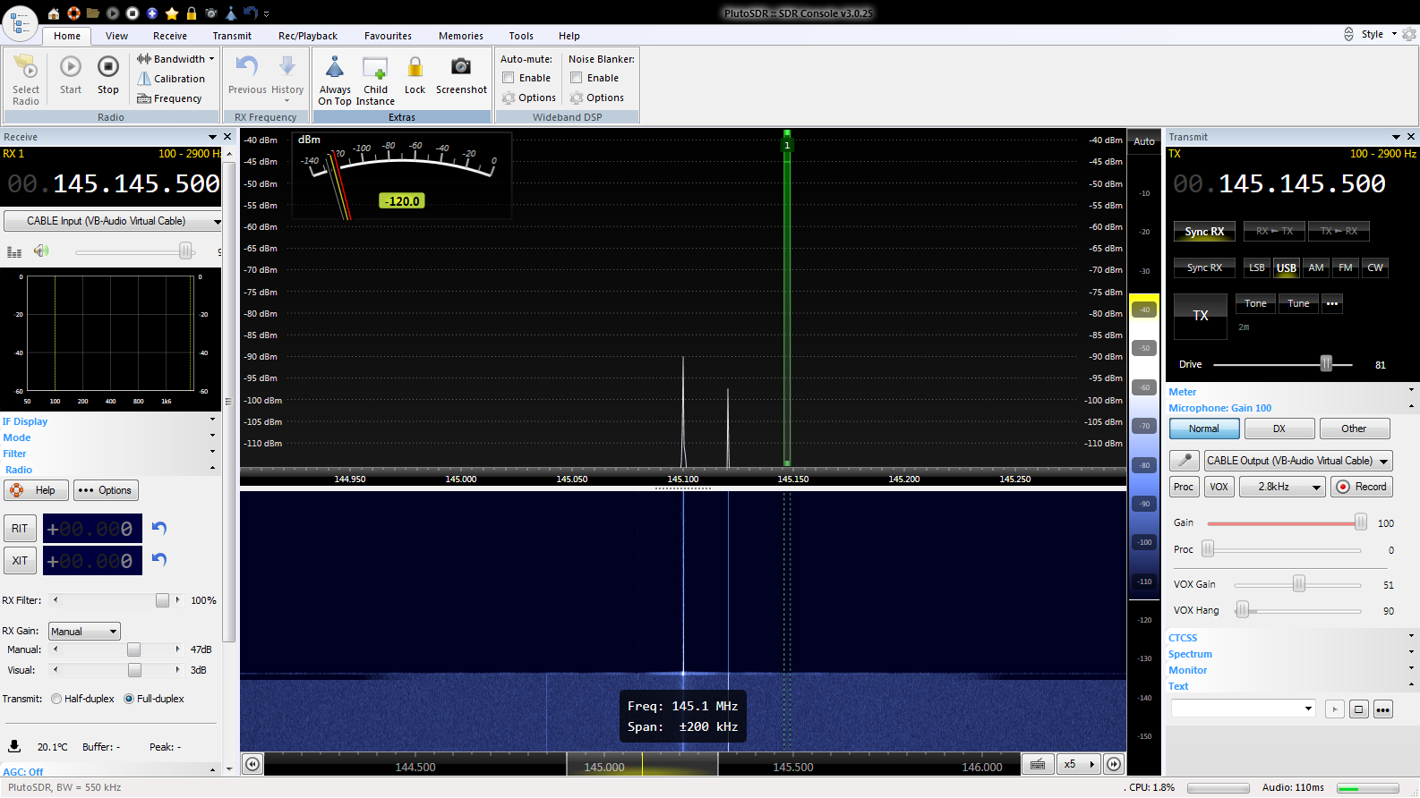

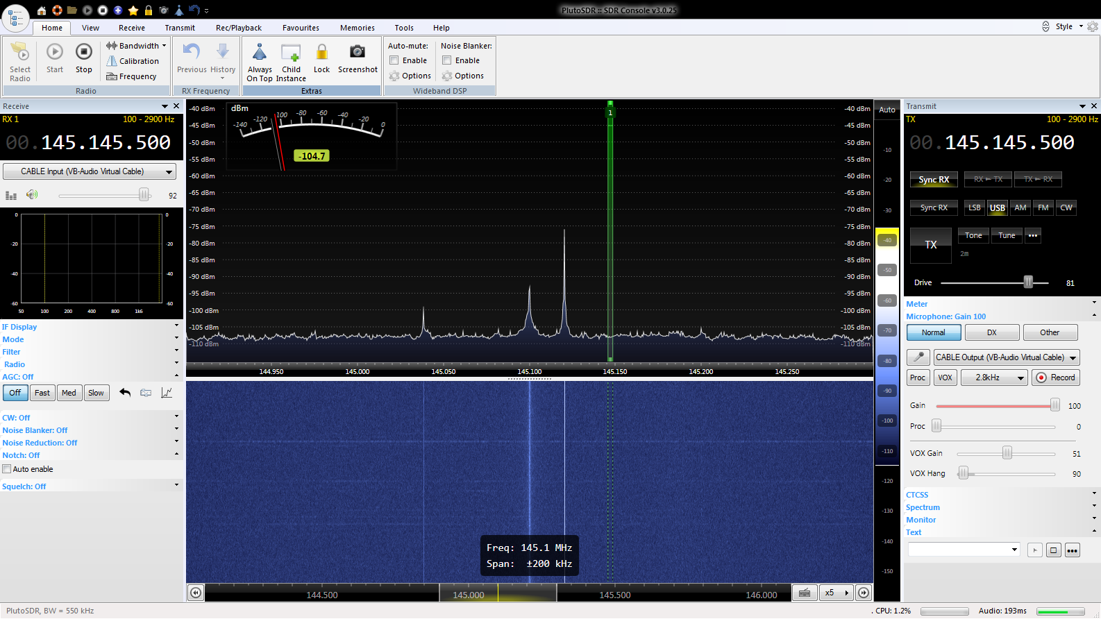

I have just modified my Pluto for external (40MHz) reference, taking care to get the level correct. All seems to be working fine, apart from a frequency offset that I (eventually) cleared by setting the offset to zero (it had a stored value, presumably what was correct for the on-board reference oscillator).
My questions relates to starting and stopping the radio. When I stop and then restart the radio, it no longer seems to be working. Screenshots attached.
The only solution I have found is to close SDRC, unplug the Pluto from PC, plug it back in and restart SDRC.
Is this normal, or am I doing something wrong?
Starting and Stopping the Pluto

Thanks Simon. Yes, the 40MHz is always present and is so before the Pluto is plugged in.
The observation is reproducible. Attached logfile of the sequence. Charlie

No, it had the same problem as identified in the above posted screenshots ie all the noise had gone, after stopping and restarting the radio. Logfile was done at the time I saw the spectrum change. Again, recovery only by closing SDRC, unplugging radio, plugging it back in (ie physically with USB connection) and restarting SDRC. This is a repeatable sequence, it it behaves this way every time.

Hi,G3WDG wrote: Thu Oct 29, 2020 12:18 pm No, it had the same problem as identified in the above posted screenshots ie all the noise had gone, after stopping and restarting the radio. Logfile was done at the time I saw the spectrum change. Again, recovery only by closing SDRC, unplugging radio, plugging it back in (ie physically with USB connection) and restarting SDRC. This is a repeatable sequence, it it behaves this way every time.
Did you try setting the RX Gain to something different than 'manual'? I experienced issues with RX gain set to manual, however they manifest themselves somewhat different as my Pluto started with a much higher gain than selected.
Btw, I see the same error 95 in your logfile when setting RX hardwaregain that I get as well.

Jean - many thanks!!!!
That solved the problem. I did indeed have the gain on Manual (probably was there by default, but can't be absolutely sure about that). With any of the other three options radio starts and stops perfectly.
73 Charlie G3WDG
