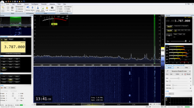

Hi all,
I have connected my HL2 using the "quick install" method, using a cat7 cable and it works well on receive but on transmit all the meters (power, swr etc.) except alc, are either all at zero or all hard over even when not transmitting. When I transmit only the alc meter moves and an external swr bridge shows that power is generated. I'm using version 3.0.25 and it works well with SDR play RSP1a but I need some help with the HL2 issue.

Please add a screenshot or two. last time I fired up the HL2 it was OK but as always things can go wrong.

Thanks for the quick reply, Simon. I'll try to post a couple of screenshots. One is on receive the other is in tx mode.

Only thing I notice on your screenshot is you have the external radio panel there. I wonder if that is something to do with it? I would not expect that there if you are running HL2 "clean"? The very first thing I would do is disable "External Radio" option on the ribbon bar then try again.
Re: HL2 tx issues
Max, thanks for the suggestion to turn off the external radio...it worked! Also thanks for the link to the .rbf file: I shall upload it shortly.
