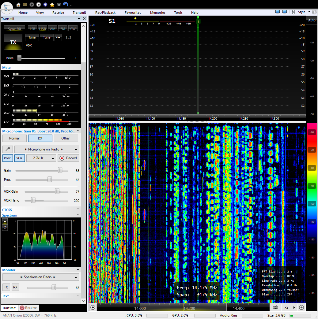

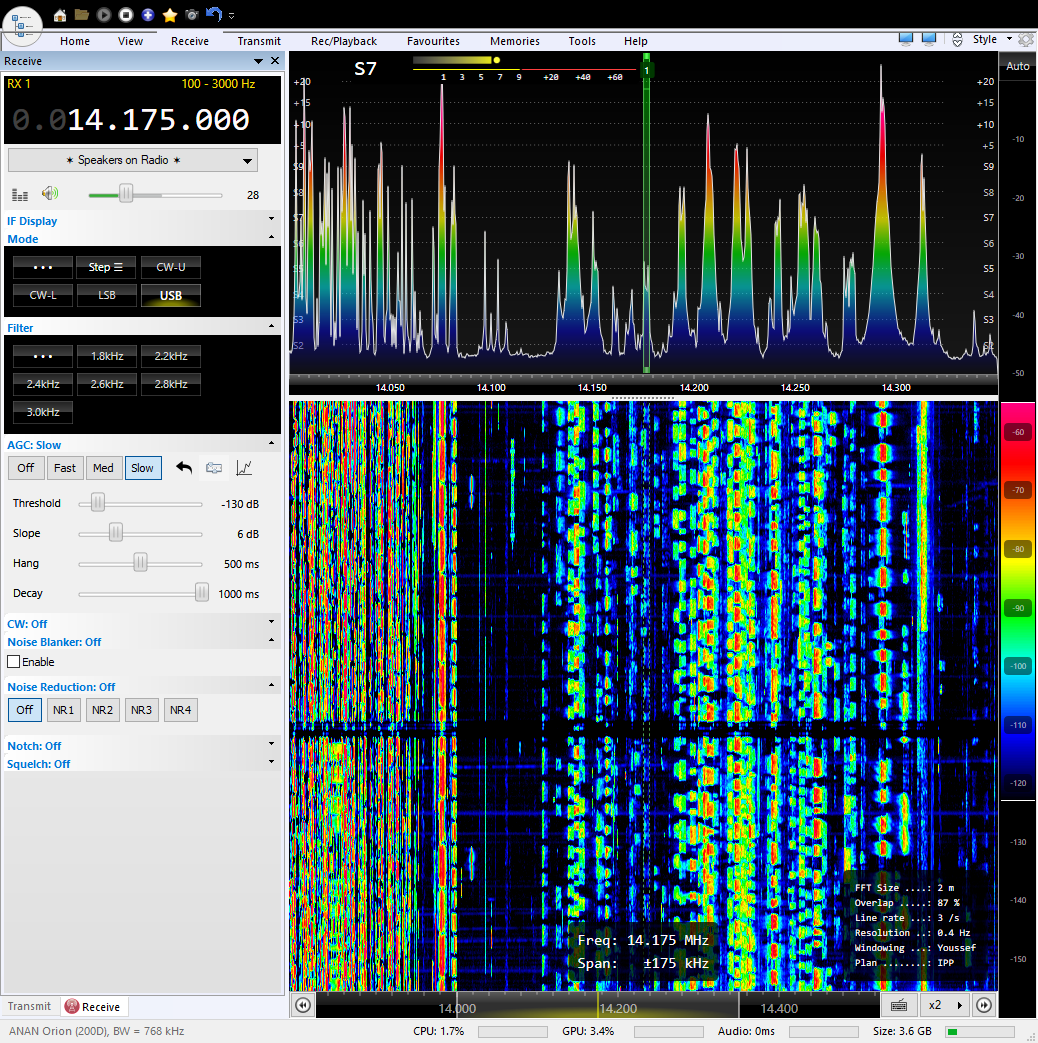

Screenshots showing settings always help, so let's see the console while in use.

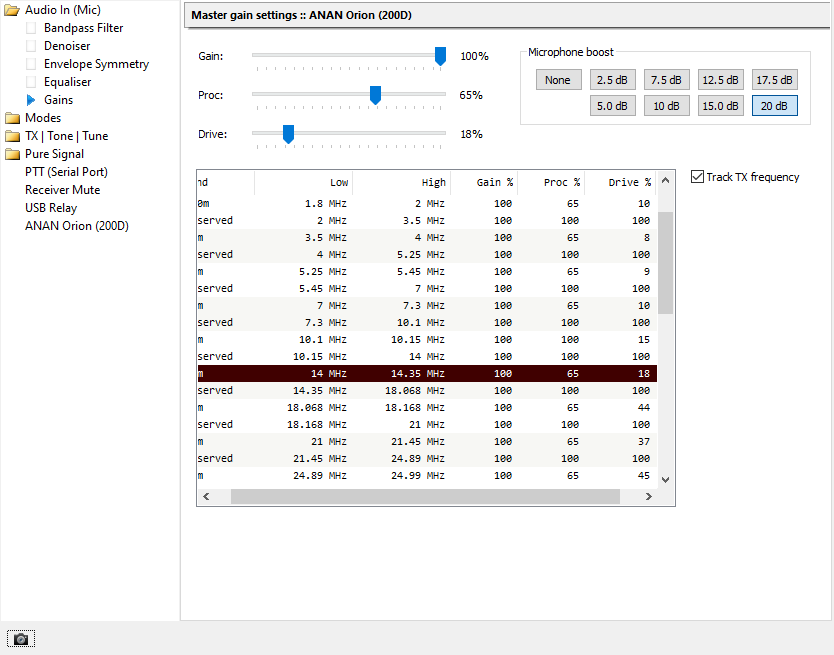

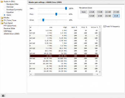

Re: Anan+SDRC- some observations and request for SSB help
Here are some sceenshots in TX and RX mode and the master gain settings.
Gains adjusted for each band to give 100 drive setting = 100W out
Equaliser not used so flat 0dB audio.
The main problems are the apparent poor audio quality as monitored and the loud noise on going to TX.
73 Dave G3ZQH
