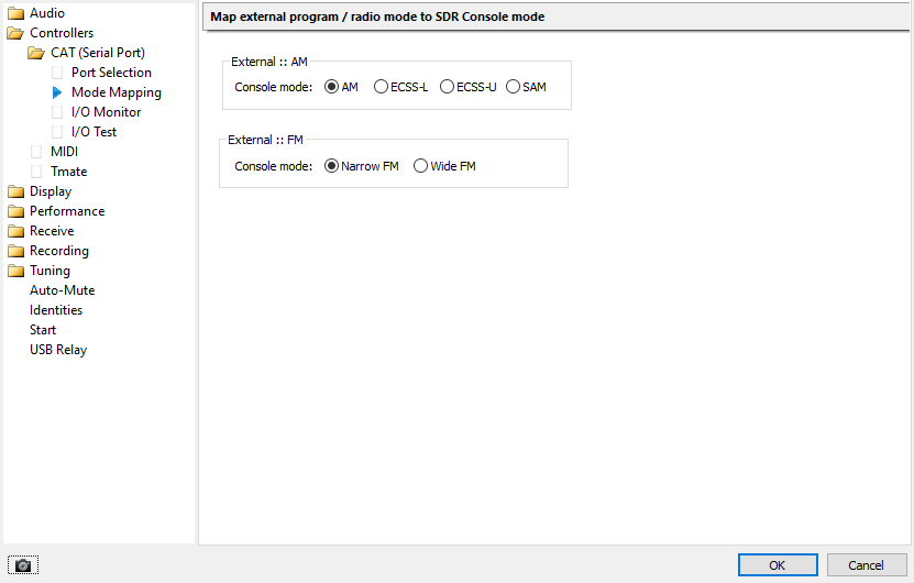

I understand you are using an external radio, do you have mode mapping enabled?

Re: AM / SAM
Unread post by oe3ide »
yes, running the Airspy HF+ discovery, controlled via OmniRig from FT-2000.
Checked the mode-mapping setting. Is on "AM".

Yes I can confirm, point and click and the mode changes from AM to SAM.
The same also applies if you are using ECSS-L or ECSS-U it also switches to SAM.
Mode mapping is set to AM for external radios.
This is only with an external radio tracking the main rain radio.
I never noticed this before myself.
