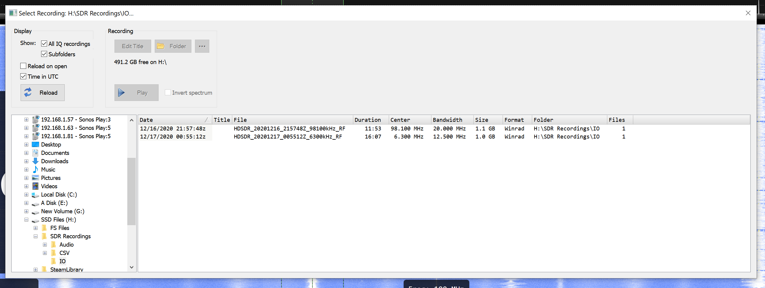

I am trying to playback a I/O recording made with other software, HDSDR in this case. When I go to the select recording page it shows the recording with the correct duration but incorrect size. When I attempt to playback the file it will only play about 15-20 seconds worth of recording. Is this a compatibility issue or some other issue that I'm missing?

Screenshot of the selection window please.
Re: Recording Playback recorded from other software
The actual file sizes are 53.1GB and 45GB

OK,
Looks like this is a HDSDR 'hack' to generate files > 2GB in size. I only support WAV RF64 conforming files > 2 GB.
