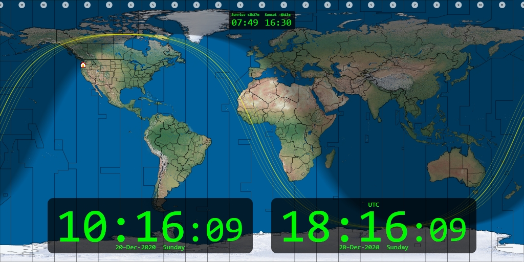

Hello Group,
I am using World Clock v1.0.15 and I am having an unusual problem. I have Greyline with Shadow enabled. When I first enable it, the display looks perfect. However, as time goes by, the edge lines move as expected but the shadow remains fixed. I have attached the screen shot. I can run the identical version of World Map on two other PCs and they both work perfectly.

Thanks for the screenshot - you're not the first person to report this but so far I failed to resolve it. Will look at this problem...

And reproduced it, new fixed kit tomorrow.
