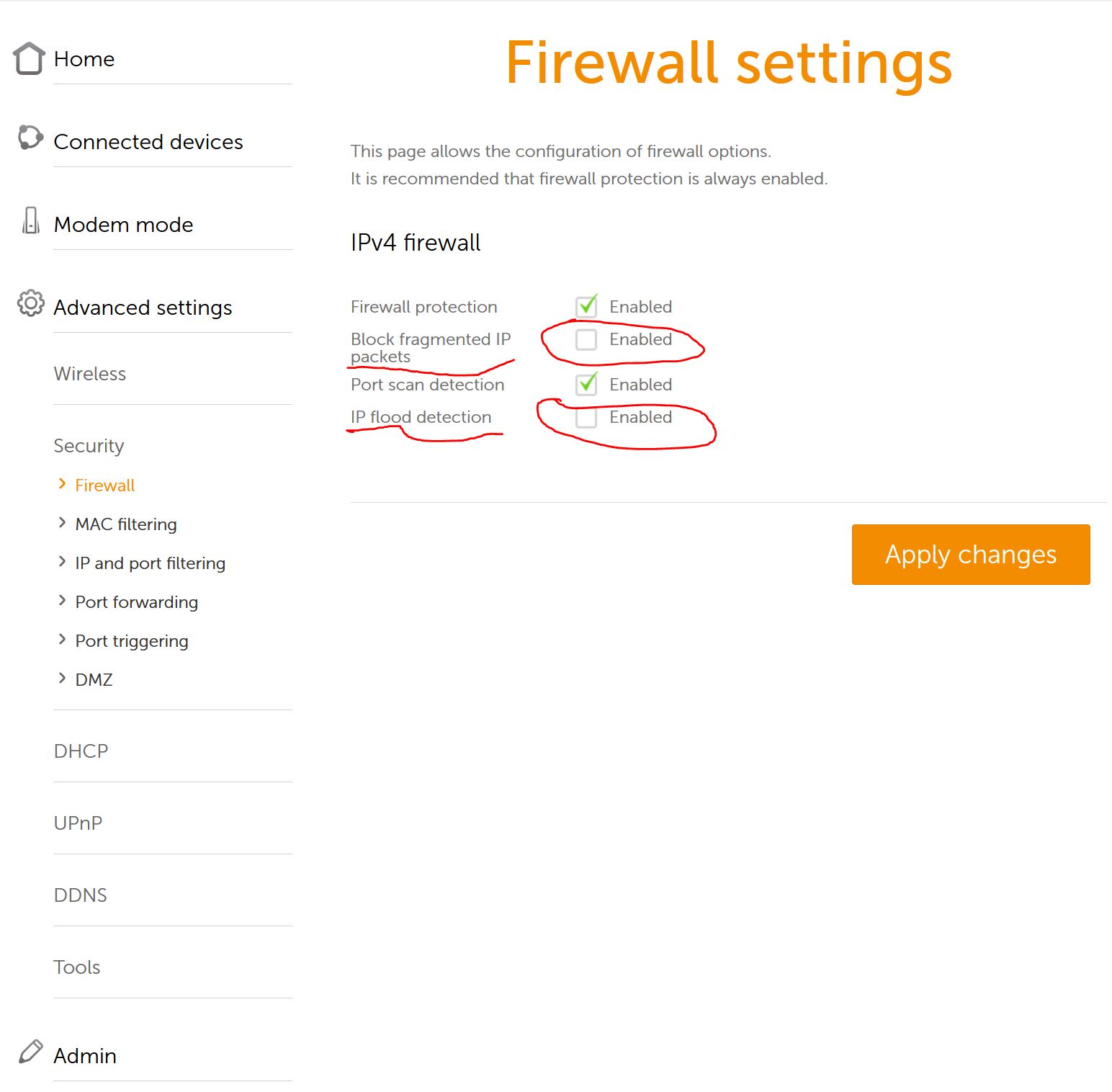

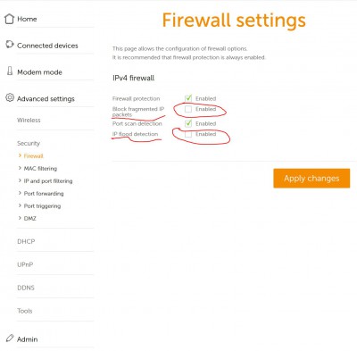

UPDATE: it has been solved, i can connect to my own SDRC Server again. :shock:
I never ever had to change this router setting before but now it did the trick: "Block Damaged IP block's" needs to be set off (unchecked). Can you check the speed again Kriss? I think it went up too... thanks again!

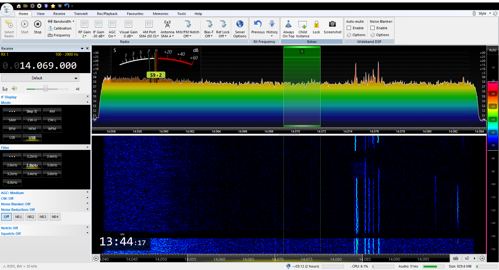

Getting intermittent stuttering (audio and visual) on 30 kHz, proceeds to get worse with higher BW's.
Yes, I can run all my servers from the laptop to which are are operating from. My usual listening station is the laptop in the kitchen, which happens to be Super Station #1. I randomly connect to one of my 5 servers, just to make sure they are functioning properly when I want to monitor the bands. I rarely connect to my SDRPlay though, prefer the Airspy HF Discoveries or the SDR-iq's due to there are too many options to choose from that will severely hamper it's operation. Plus, when one connects, the settings from the previous user are used on the next user. So if somebody doesn't know how to use the radio, it takes time to get all the settings back to a reasonable radio. Took me a while to get tame the high signal levels on your RXR, and choose the proper antenna. Hint- You may want to offer suggestions in the Comments section of the 'On Air' tab of the Server Service. I can't seem to get the noise floor below S-8/9 without severely reducing hearing/seeing anything.
Example 20M in attachment

Re: Please test my server
Kriss,
I listened to your advise and added some "how to use" info to the server login.
I had the same stuttering when i was listning to one of your remote radio's so i searched further and solved it :)
It was also a setting in my (ISP) router firewall: IP Flooding detection must also be off.
(picture for those who have the same router) Thanks again
