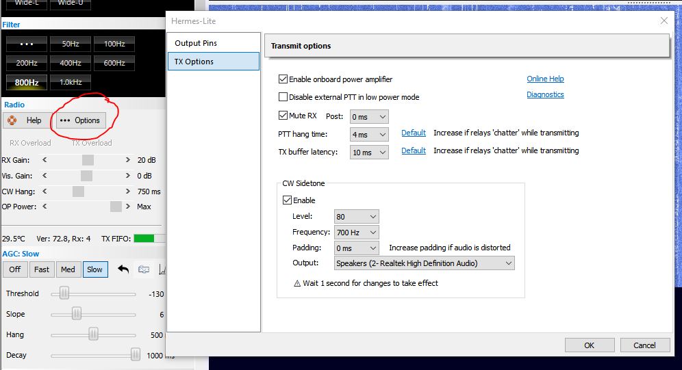

I have regular HL2. Had no issues at all with the sidetone which works very well.
Did you set the options in the "TX options" menu? (see attached picture).
Otherwise I wonder if something specific to the HL2+?
The headphone audio jack on the HL2+ I cannot help with. Did you try the HL2+ group for support on that one? As I say, have stock unit here and after a few small issues very early on it is pretty much all sorted. Simon may offer help, but then again he may only offer support for the unmodified unit?
