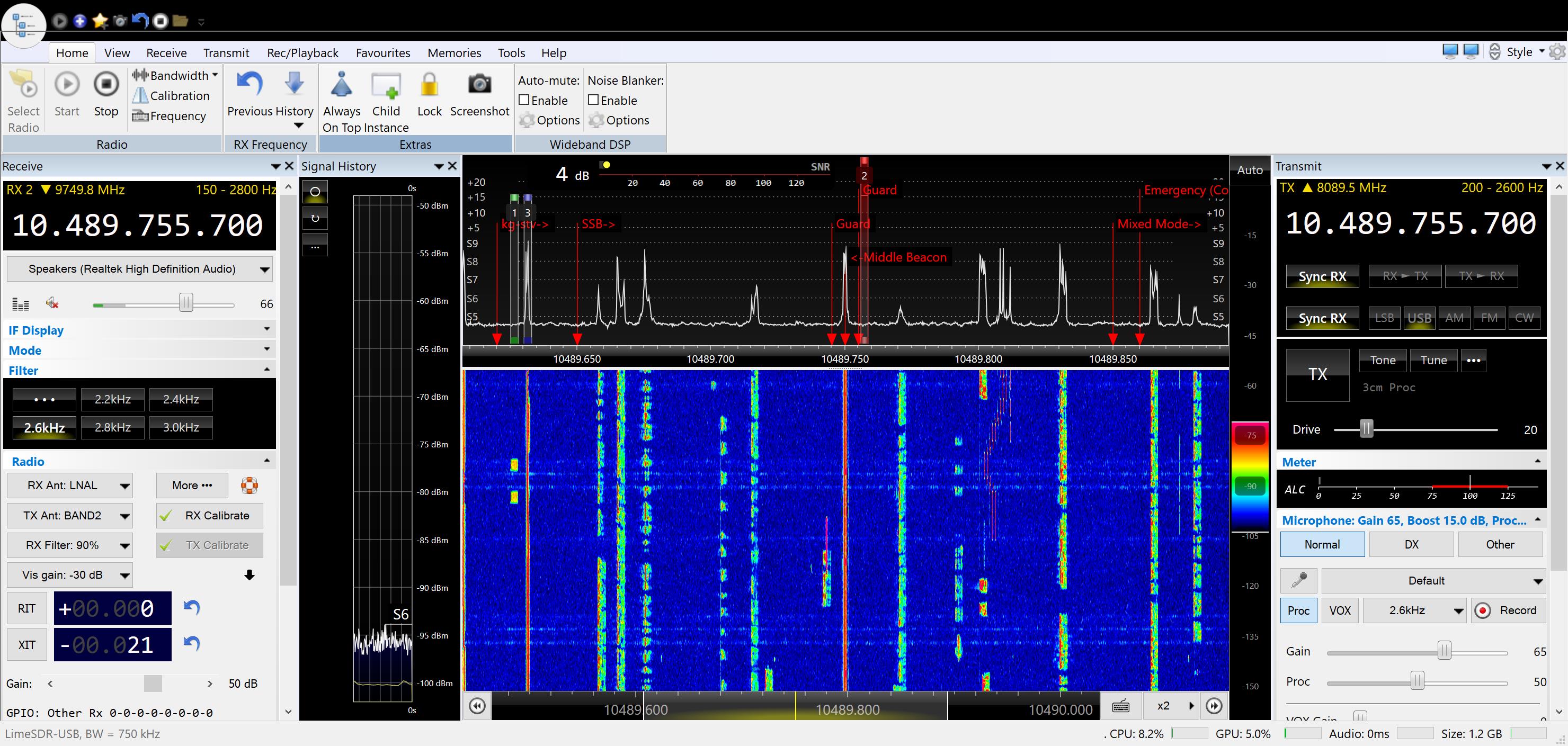

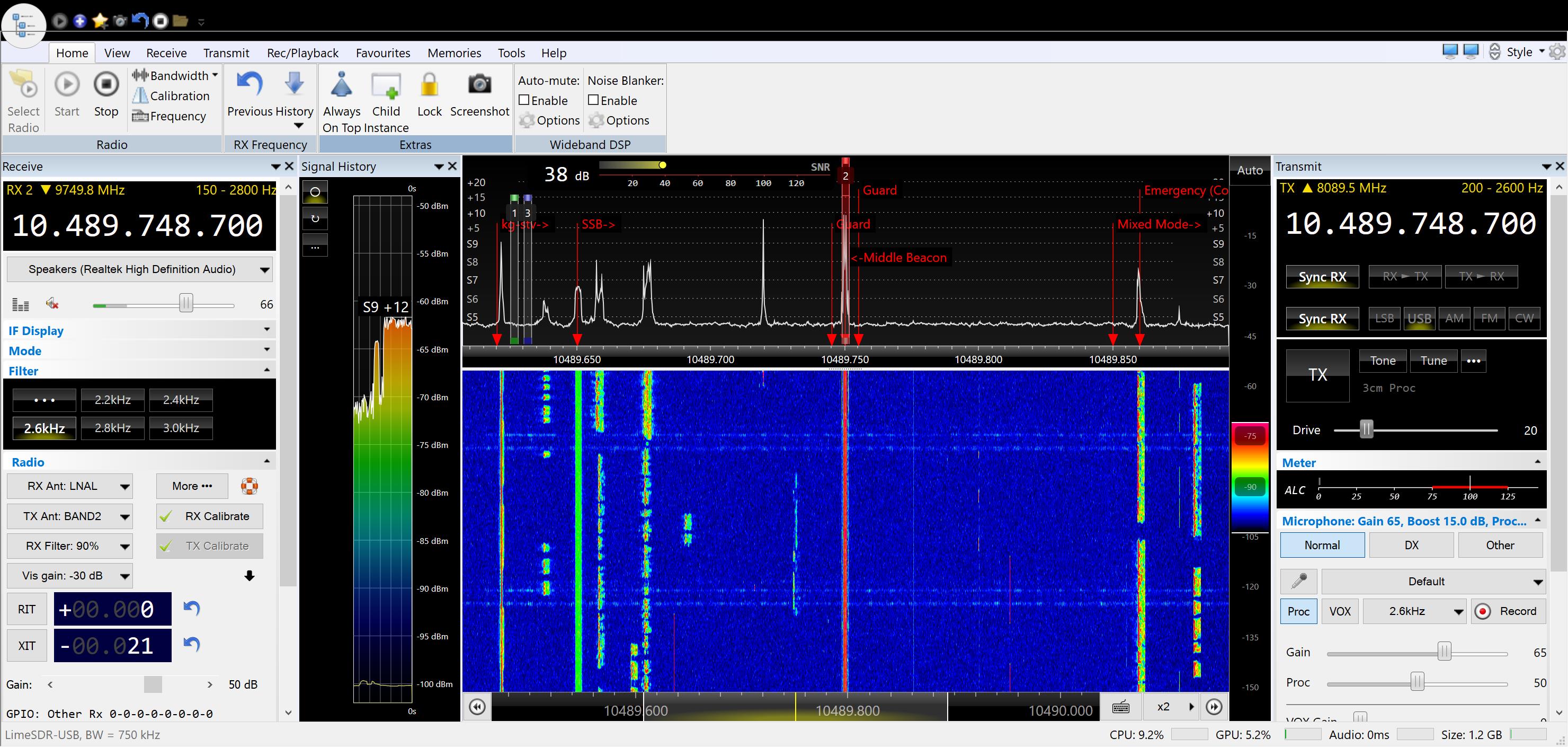

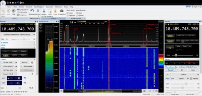

Hi Simon.
Attached a screenshot shoing S/N of 38 (get 32-40 depending of the data on the beacon).

Re: QO100 beacon signal level
Hi
To add: Just noise is S6 S5 on signal history
So levels are similar to the display of the Goonhilly site...
