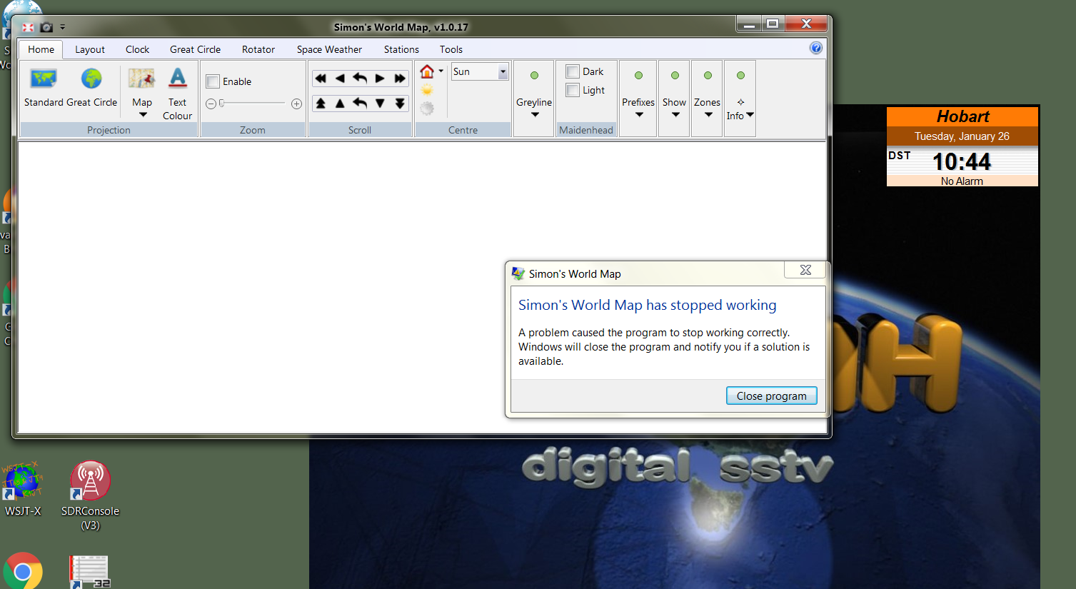

I have just downloaded and installed the world map program, all seems OK with the installation but when running the program Windows comes up with the message "Simons world map has stopped working a problem caused the program to stop working"
I have tried re-installing and re-starting with no success. I am using Windows 7 Ultimate on a HP Compaq computer (dated) but runs my SDR-Play with SDR-Console OK (latest update)

Thank you Simon, I would send you a screen shot if I knew how to attach it to this reply !

Re: Program will not run
Hope this works ,73 Mike.

I used a USB stick and transferred the downloaded program from my station computer over to my laptop which runs Windows 10. No problems! installed OK and program runs perfectly.
This at least proves the download was not corrupted by my station PC, of coarse whats happening in Windows 7 is the problem.
