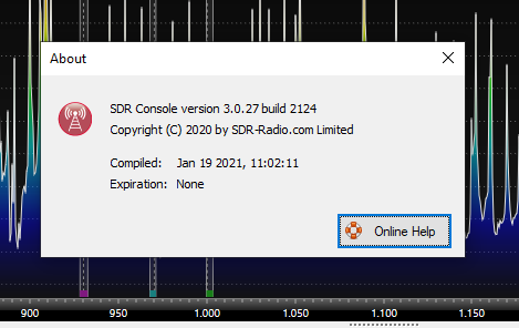

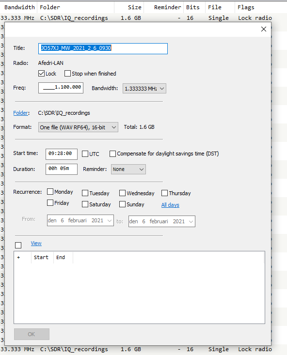

Running Scheduled Recording with v3.0.27 build 2124 of January 19, 11:02 the radio (AFEDRI) is stopped at the end of recording even that the new box (Stop when finished) is not checked.
This is not desirable.

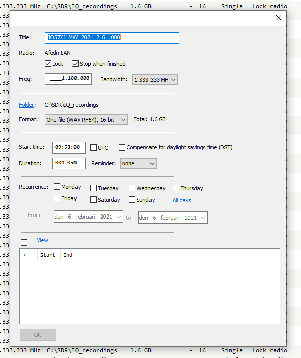

The radio is stopped at the end of the recording also when the new box (Stop when finished) is checked.

Will fix later today, then make a new 3.0.27 test kit.
- Posts: 2187
Re: Scheduled recording stops radio at end
Just looked - saw a bug. Test team kit later today if you're good.
