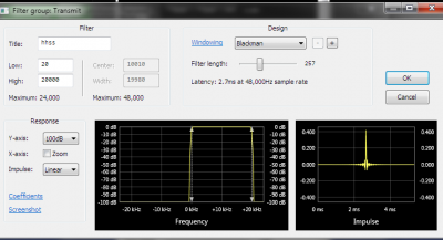

is it possible to set TX Bandwidth, both audio and RF to 22kHz? I made a custom filter, but it seems only 4k is coming through.

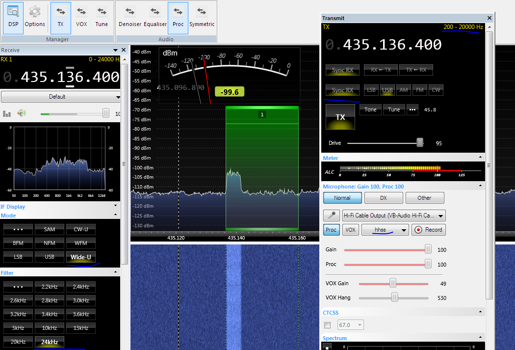

Audio BW is set to 20 - 20000Hz
Using Sync RX while having Wide-U selected at 24kHz
As input I'm using Goldwave's own noise generator, full range for 44.1kHz stream, fed through Hi-Fi Audio Cable Anything else should be checked?

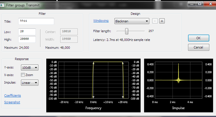

'hhss' (sorry for the name) uses 20-20000Hz response, using Blackman window:

This is just the main filter, there are other filters in the modulation chain (not easy to write) which prevent you generating more than 6kHz using SSB.
