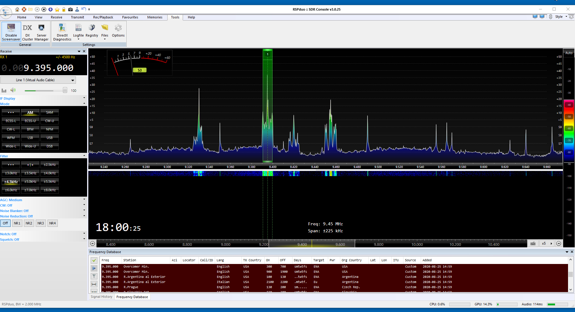

The latest SDR Console V3 test kit (August 17th 2020) failed tonight when using the V3 API. . Attempts to select the SDRplay RSPduo yielded a frozen screen. So, I uninstalled the kit and removed the SDR Console V3 entries in the registration file. After the reinstall completed, I had a working installation with the RSPduo and V3 API. As I was making the configuration changes to suit my preferences, I stopped Console, changed the Sample rate and restarted the RSPduo. It immediately froze up.
Attached is the screen shot and the log file.

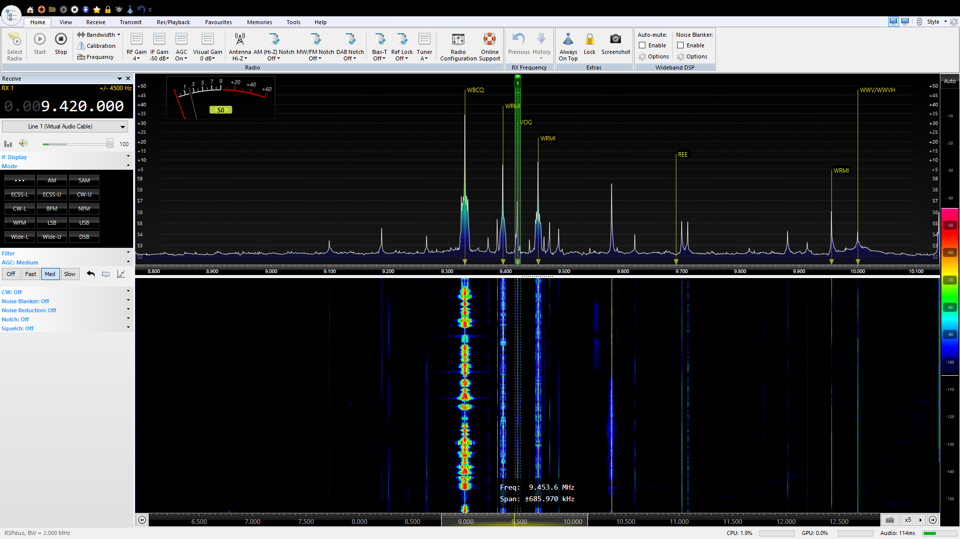

Well, it happened again however I think I have a better clue. This freeze happened within the first second after starting. Up until this point, I could not get the RSPduo restarted after a freeze. But with what I read in the log file, I'm now thinking it is VAC related. As soon as I change the audio out from Line 1 (Virtual Audio Cable) to any other working audio, the RSPduo began to respond. Even switching back to the VAC worked.
Attached are the screenshot and log.
